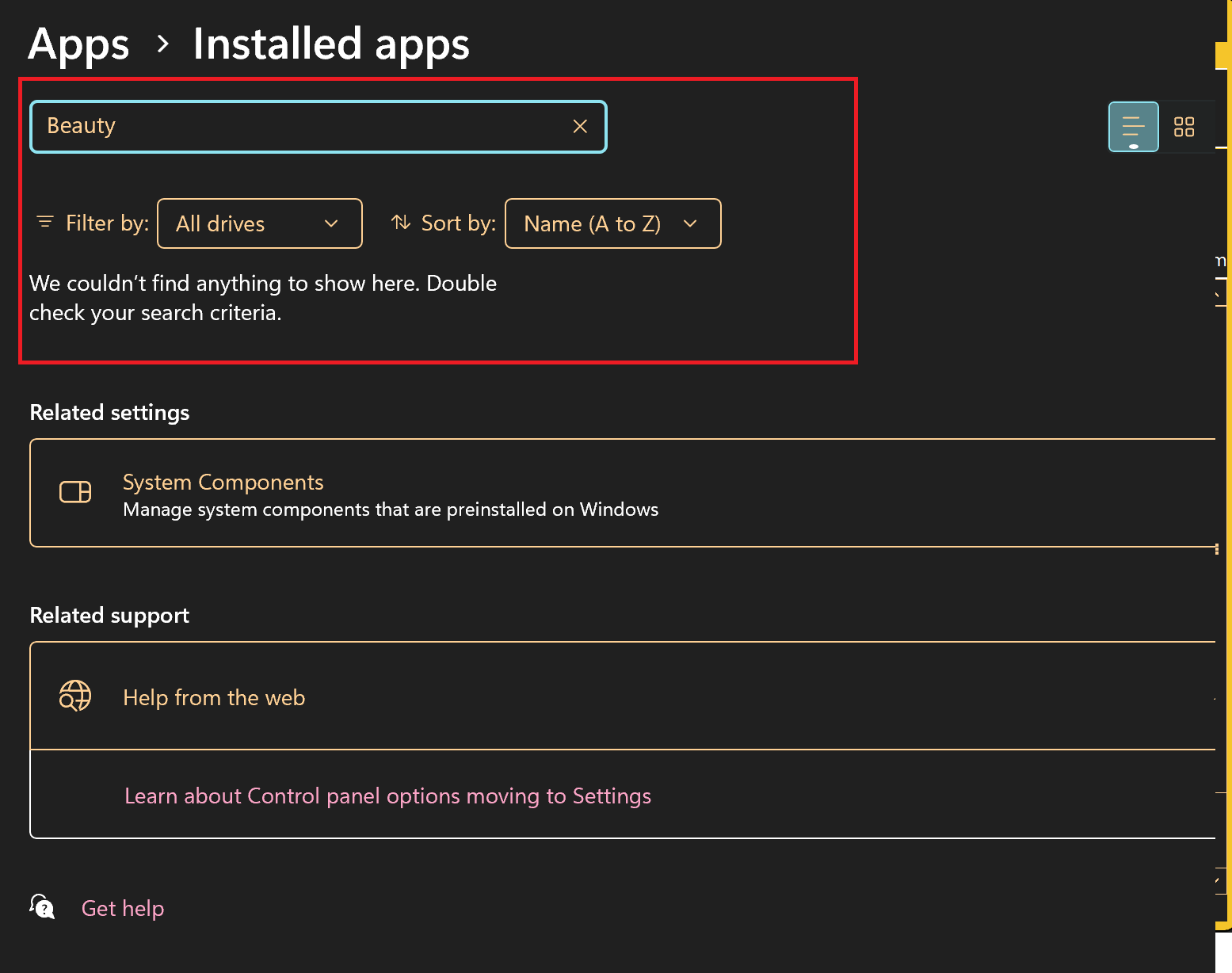

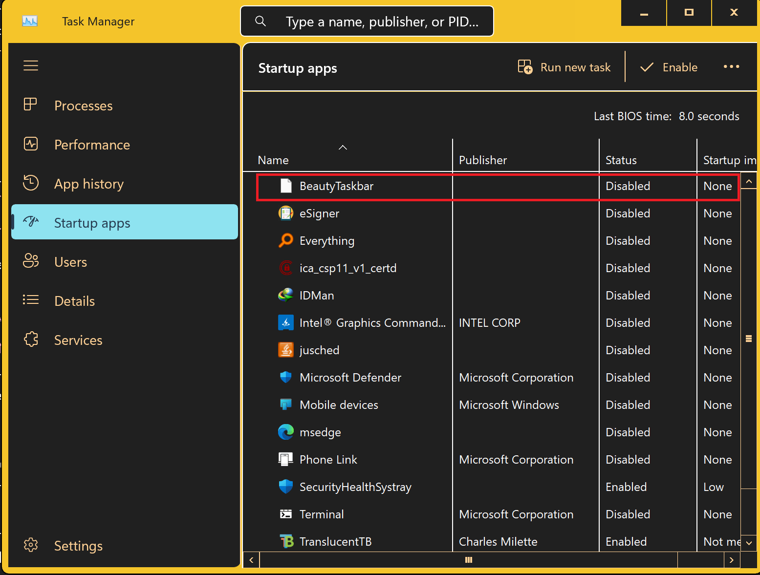

I Uninstalled one Program name Beauty Taskbar and on Task Manager it shows no file location on right click.
But recently i found that this program still appears in Task Manager as you can see here.

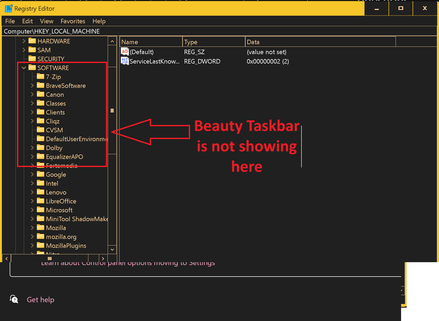

  1. I checked Registry Editor but it is not there.

  5. In Task Manager it was showing enabled and i Disabled it.
My question is, why it is still appearing in my Task Manager when it is already uninstalled from Installed Apps menu and how to delete it?

  1. DaveM121 816.9K Reputation points Independent Advisor
    2024-04-05T12:32:08+00:00
    Hi, I am Dave, I will help you with this.
    There is a registry key left over from that uninstalled software that is causing it to still appear on the Startup tab.
    Click the link below to download a small free utility that does not require installation.
    https://download.sysinternals.com/files/Autorun...
    When the file downloads, unzip it.
    Run Autoruns64 as Administrator
    Select the Logon tab at the top of Autoruns, you should be able to find the entry for that app, then right click and delete it from there.
    Restart (not shut down) your PC to apply that change.
