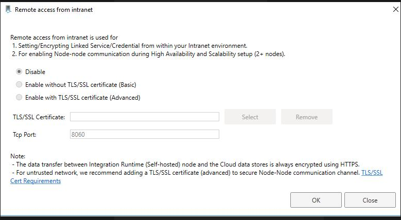

I have two nodes running on my integrated runtime however during an update the the self hosted IR's one of the nodes after updating threw an error of "Authentication Key Invalid" so we uninstalled the runtime on that server and re-installed and registered it using the key. This is all we keep getting:
This was working fine before the update what would be causing this issue. I have looked though the logs and found the following:

  1. KranthiPakala-MSFT 46,642 Reputation points Microsoft Employee Moderator
    2021-05-21T21:58:54.473+00:00
    Hi @Jed Fletcher ,
    Thanks for reaching out and using Microsoft Q&A forum.
    When you reinstalled the IR in the machine that it is failing, have you reinstalled the same version that is there in the other node? If not, please make sure both the SHIR version are matching on the VMs. Also please make sure that the credentials between the both the nodes are in sync. if you think they are not in sync, then you can generate credential back from the working node and import into the node that is having issue.
    Do let us know how it goes.
    Thanks
