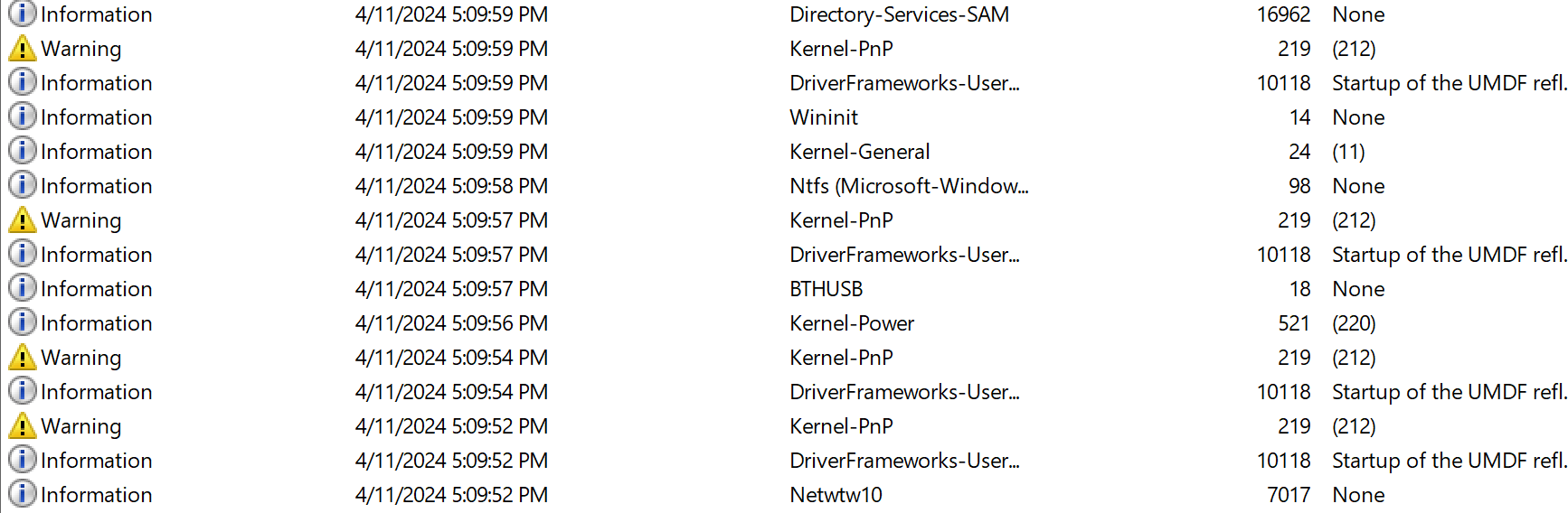

Here is the exact errors I am getting, in the order they happen:
The driver \Driver\WudfRd failed to load for the device HID\VEN_8086&DEV_A0D0&SUBSYS_00561414&REV_20&Col09\4&118ccbb9&0&0008.
The driver \Driver\WudfRd failed to load for the device HID\HID_DEVICE_SYSTEM_VHF\6&195f13a0&0&0000.
The driver \Driver\WudfRd failed to load for the device {98DE32A9-5D44-419E-B67D-66072BCEF58B}\SurfaceSarManager\3&9c21b90&0&SID_DEVICE_04.
The driver \Driver\WudfRd failed to load for the device HID\Vid_8087&Pid_0AC2\6&122942c4&0&0000.
The driver \Driver\WudfRd failed to load for the device DISPLAY\LGD0555\4&de0e589&0&UID8388688.

    As you can see from the screenshot you provided, there are records of DriverFrameworks, which are described as Startup of the UMDF refl.
    This is related to PNP (plug and play) device drivers, and as you can imagine, the problem is most likely related to the USB port on the Surface.
    I recommend that you first consider contacting IT to update your Surface firmware driver, which can be done via the following link:
    Download drivers and firmware for Surface - Microsoft Support
    This site is a guided support page to assist you with firmware and driver updates from the beginning of step 1.
    If your IT staff has a fair amount of Surface experience, it's more efficient to pull down the support page directly to the manual update step, which directly selects the Surface model and lists what can be updated by model.
    When your Surface is finished with all the updates, try the screenshots again.
