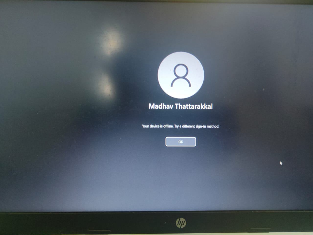

So, I have a hp laptop. Series : HP 15s-eq2143au. OS is Windows 11 Home. Processor: AMD Ryzen 3 5300U. Ram: 8GB
Storage 256 GB. I listed everything i know about it. So, at morning i opened laptop and decided to connect to my phone's personal hotspot then the wifi icon on laptop was not showing this happens a lot i tried to troubleshoot by restarting then a blue screen appears and says
Your device ran into a problem and needs to restart.
We'll restart for you.
(Displays a qr code) For more information about this issue and possible fixes, visit https://www.windows.com/stopcode
If you call a support person give them this info: Stop code: UNMOUNTABLE_BOOT_VOLUME
And it shuts down after showing this for a couple of seconds then again starts and shows this screen it repeats this.

Hi Madhav, can you use a LAN or wired connection on the PC so that you can log in? and just to confirm, the initial issue you have which the error UNMOUNTABLE_BOOT_VOLUME is now gone?

    Yes, the error UNMOUNTABLE_BOOT_VOLUME is now gone. After using a wired connection to login my issue has been solved thank you for helping me. Hope you have a good day sir.
