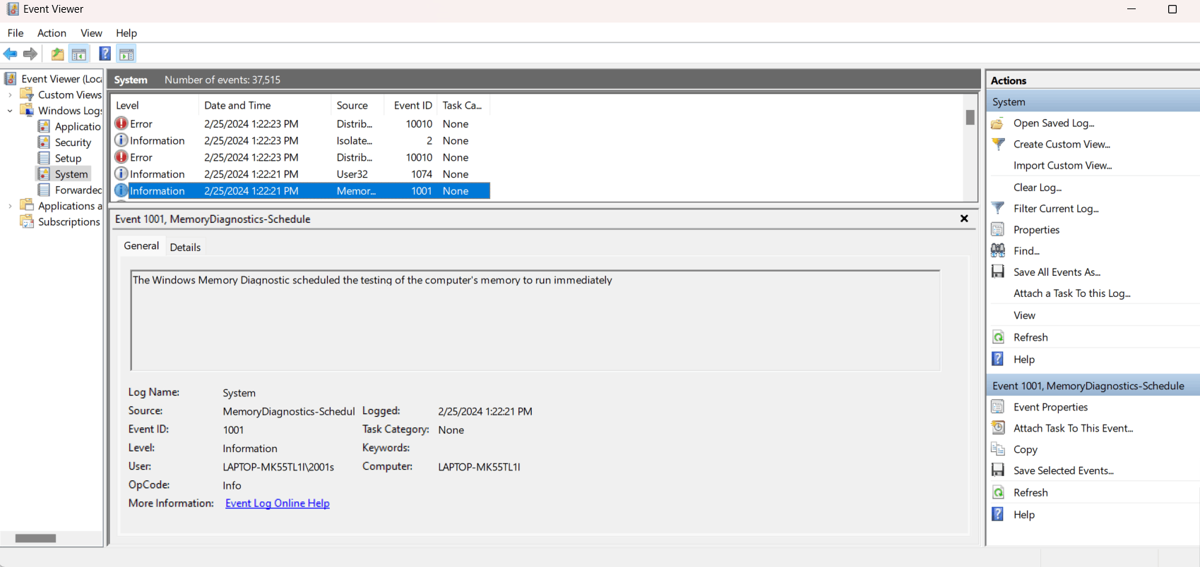

  2. Igor Leyko 111K Reputation points Independent Advisor
    2024-02-25T23:21:37+00:00
    Please check other events.
    To switch test to extended mode, run it, then press f1 key and select this mode.
    2024-02-25T22:15:46+00:00
    Thank you for replying. I did try to find the results with the Event Viewer, but I do not know how to interpret them. So I will attach a screenshot so you can make sure I'm looking in the right place.
    I do not know how to run the memory diagnostic in extended mode. When I click on it my only options are to run it now or later. If you could explain how to do that it would be very helpful.
    I ran the command to repair the system files and it said that it was a success.
