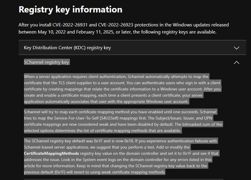

    However, I found an article that might be related to the issue you're experiencing:
    KB5014754—Certificate-based authentication changes on Windows domain controllers - Microsoft Support
    Different network cards may have variations in how they handle certificate mapping due to different implementations. You can compare the certificates used by Intel and Realtek network cards for authentication and check if there are any differences in the subject, issuer, or UPN fields. Additionally, you can contact the network card manufacturer to learn more about how they support certificate mapping methods.
    Please note that making changes to the registry can have significant impacts on the system, so be cautious. For added protection, before making edits based on officially published Microsoft documentation, be sure to back up the registry. Then you can restore it if a problem occurs: How to open Registry Editor in Windows - Microsoft Support
