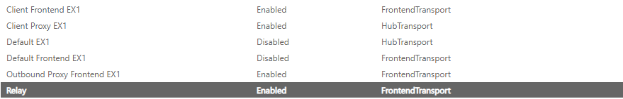

    Hi @CWT ,
    Good day!
    For this error, I think it's because of the settings on Receive Connectors.

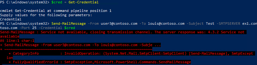

    I did a test, if I disabled other Receive connectors and leave the one I created with the same settings as what you've made. I could meet this error when I wanna send from other user that's different with $creds.
    The Relay receive connect is TLS, BA, Integrated Windows Auth enabled and only Exchange users enabled for permission groups. And the IP range is set to include the test server.
    Other server will receive the error like this:

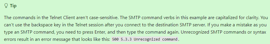

    And for the Telnet part, I tested it with the steps of the document, and it could work without error.
    This has a explanation in the document, after I added the anonymous users to the permission group of the Relay connector, it worked.
    I have to apologize that I don't usually use telnet and I know only a bit of it, you can post the cmdlets you run on telnet here so we could better find the reason.
