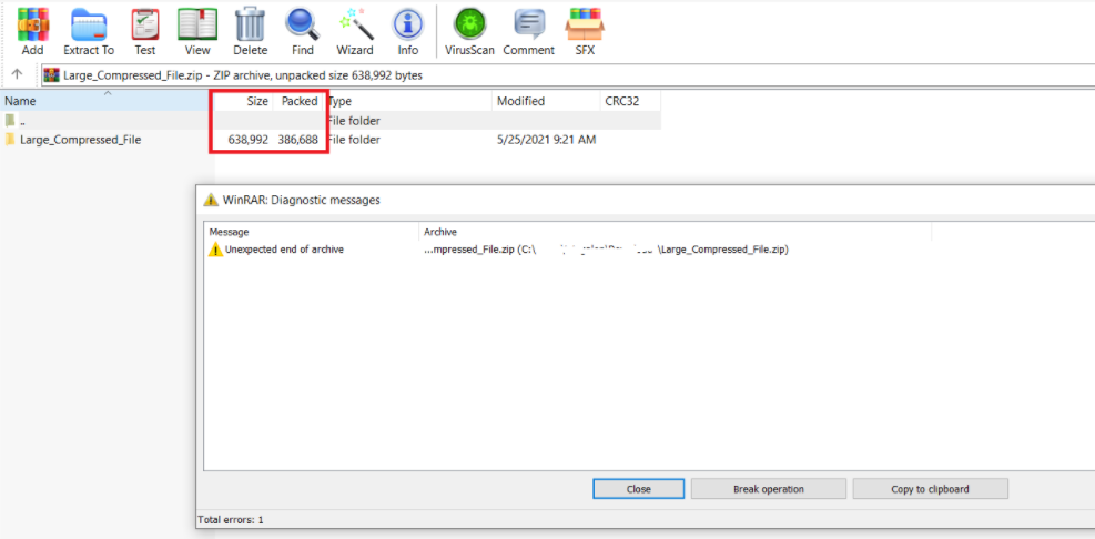

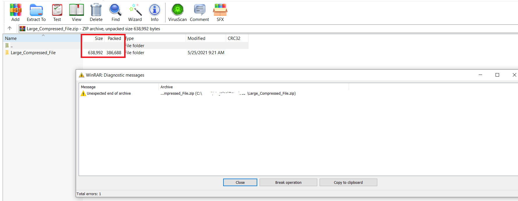

**File details uploaded using graph API:
Getting Below error when I try to open the zip file after uploading via graph API

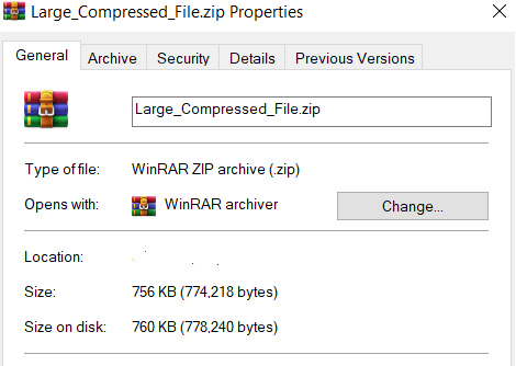

**File details uploaded Manually:

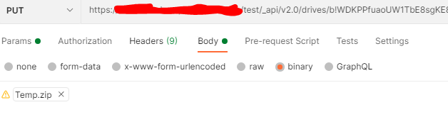

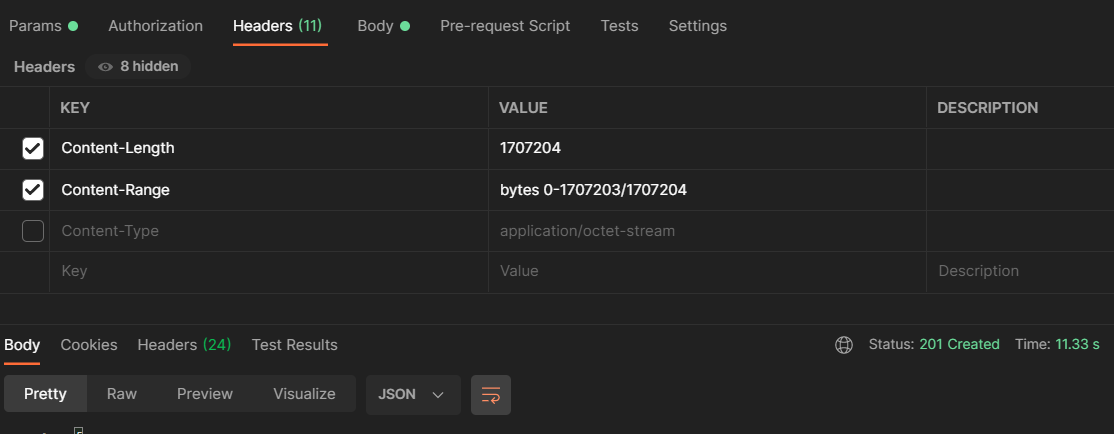

    I did a test to upload zip file with graph api, the zip file worked well on my end. You could try to upload file using uploadurl like the below:
    Body:
    Header:
