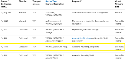

    As per the error looks like the outbound 1433 port is blocked. There are a couple of NSG rules that are required for APIM to be deployed and function correctly in a VNET as mentioned in this document. You need to add the rule as mentioned in the document to ensure there are no issues when trying to connect to SQL endpoints.
    Source Port: *
    Destination Port:1433
    Protocol: TCP
    Source Service Tag:Virtual Network
    Destination Service Tag: SQL
