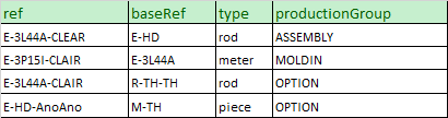

The result I get looks like this:
Then I transform this result to rotate it using the Pivot method but I find my result in are unordered:
Here is my method of trying to pivot my information:
SELECT [ref], [baseRef], [type], [productionGroup]
FROM
 SELECT
  x.y.value('local-name(..)', 'VARCHAR(MAX)') ParentElementName
 ,x.y.value('local-name(.)', 'VARCHAR(MAX)') Attribut
 ,x.y.value('.', 'VARCHAR(MAX)') Valeur
 ,CAST(Row_number() Over(Partition by x.y.value('local-name(.)', 'VARCHAR(MAX)') order by x.y.value('local-name(..)', 'VARCHAR(MAX)') ASC) as varchar(10)) as rn
 FROM @xmlDescriptive.nodes('//@*') AS x(y)
 WHERE x.y.value('local-name(..)', 'VARCHAR(MAX)')= 'Material'
) d
pivot
  max(Valeur)
  FOR Attribut in ([ref], [baseRef], [type], [productionGroup])
) piv
I am a little confused. I would like to have my result formatted this way but ordered. What is wrong with my reasoning?

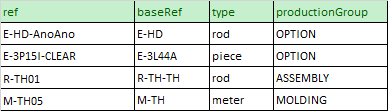

I would like my result to be presented like this:

  1. Yitzhak Khabinsky 27,091 Reputation points
    2021-05-26T00:14:28.807+00:00
    Hi @JF Landry ,
    I took a liberty and fixed your XML based on my limited understanding of your data.
    Check it out.
    SQL
    -- DDL and sample data population, start
    DECLARE @xml XML =
    N'<Model xmlns:dsc="ModelDescriptive" xmlns:draw="ModelDraw"
           xmlns:display="Display" xmlns:thd="Model3D">
    	<dsc:Model name="15DE">
    		<dsc:Defs>
    			<dsc:Materials>
    				<dsc:Material ref="E-HD-AnoAno" baseRef="E-HD" type="rod"
    				              productionGroup="OPTION"/>
    				<dsc:Material ref="E-3L44A-CLEAR" baseRef="E-3L44A" type="piece"
    				<dsc:Material ref="R-TH01" baseRef="R-TH-TH" type="rod"
    				              productionGroup="ASSEMBLY"/>
    				<dsc:Material ref="M-TH05" baseRef="M-TH" type="meter"
    				              productionGroup="MOLDING"/>
    			</dsc:Materials>
    		</dsc:Defs>
    	</dsc:Model>
    </Model>';
    WITH XMLNAMESPACES ('ModelDescriptive' AS dsc)
    SELECT c.value('@ref', 'VARCHAR(100)') AS [ref]
    	, c.value('@baseRef', 'VARCHAR(100)') AS [baseRef]
    	, c.value('@type', 'VARCHAR(100)') AS [type]
    	, c.value('@productionGroup', 'VARCHAR(100)') AS [productionGroup]
    FROM @xml.nodes('/Model/dsc:Model/dsc:Defs/dsc:Materials/dsc:Material') AS t(c);
    Output
    |      ref      | baseRef | type  | productionGroup |
    | E-HD-AnoAno   | E-HD    | rod   | OPTION          |
    | E-3L44A-CLEAR | E-3L44A | piece | OPTION          |
    | R-TH01        | R-TH-TH | rod   | ASSEMBLY        |
    | M-TH05        | M-TH    | meter | MOLDING         |

    As you may have seen, I am not an expert with XML and XQuery. I believed that by providing a small sample of the XML file, I could get some insight into the problem. I had failed to give any attributes so by taking a closer look at your answer, I found my solution.
    Using your sample, I found the answer. It would look more like this:
    DECLARE @xml XML =
     N'<Model xmlns:dsc="ModelDescriptive" xmlns:draw="ModelDraw" xmlns:display="Display" xmlns:thd="Model3D">
         <dsc:Defs>
             <dsc:Materials>
      </dsc:Materials>
     </dsc:Defs>
     </dsc:Model>
     </Model>';
     -- DDL and sample data population, end
      ;WITH XMLNAMESPACES ('ModelDescriptive' as dsc, 'ModelDraw' as draw, 'Display' as display)
      FROM @xml.nodes('descendant::dsc:Model/dsc:Defs/dsc:Materials/dsc:Material') AS t(c);
    While looking on the web, I also found that a part was missing : descendant::dsc:Model/dsc:Defs/dsc:Materials/dsc:Material
    The end result is now ordered.
