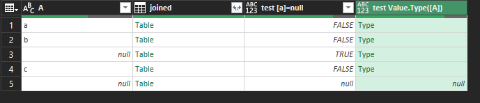

When a table is created, an empty cell will be assigned null. Also, when creating a nested joined table with joinkind.fullouter, null will also be written into the table for rows that are present in the right table but not in the left.
The first null responds as documented where [column] = null will return True or False, and Value.Type will return: Type Null.
However, the null returned as a result of the Table.Join(......,JoinKind.FullOuter) does not respond this way.
What is going on?
How can I test for null when the null is created by the Table.Join method?
Note that if I expand the table, the null will now test correctly.
To demonstrate the problem, run the below code.
let
    Source1 = Table.FromRecords({
        [A="a"],
        [A="b"],
        [A=null],
        [A="c"]
    type1 = Table.TransformColumnTypes(Source1,{"A", type text}),
    Source2 = Table.FromRecords({
        [A="c"],
        [A="d"]
    type2 = Table.TransformColumnTypes(Source2,{"A", type text}),
    combo = Table.NestedJoin(type1,"A",type2,"A","joined",JoinKind.FullOuter),
    #"Added Custom" = Table.AddColumn(combo, "test [a]=null", each [A]=null),
    #"Added Custom1" = Table.AddColumn(#"Added Custom", "test Value.Type([A])", each Value.Type([A]))
in
    #"Added Custom1"
In the screenshot, row 3 was created directly; row 5 is the result of a Nested Join operation

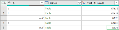

  2. Lz._ 9,016 Reputation points
    2021-05-26T15:51:45.32+00:00
    Hi @Ron Rosenfeld
    Works for you (How can I test for null when the null is created by the Table.Join method?)?
    let
            { [A="a"], [A="b"], [A=null], [A="c"] },
            type table [A=text]
            { [A="c"], [A="d"] },
            type table [A=text]
        JoinedFull = Table.NestedJoin(Source1,"A", Source2,"A",
            "joined", JoinKind.FullOuter
        IsItNull = Table.AddColumn(JoinedFull, "Test [A] is null", each
            try Logical.From([A] is null) otherwise null, type logical
    in
        IsItNull
  3. Ron Rosenfeld 271 Reputation points
    2021-05-26T16:20:57.127+00:00
    Thank you, Lz
    I see that it works, and is a lot more succinct than my workaround, but can you explain why it works?
    I see that Logical.From([A] is null) returns null for row 5.
    Why does using try .... otherwise null coerce it to True?
  4. Lz._ 9,016 Reputation points
    2021-05-26T17:50:19.607+00:00
    @Ron Rosenfeld
    Not easy to explain. Let's see...
    Look at function Logical.From. It returns a Logical from the value argument (expect if the latter is null). In this case the value arg. is "[A] is null" (a Logical test)
    With try SomethingLogic otherwise SomethingElse you get a logical in any case. I could have written:
    try Logical.From([A] is null) otherwise "Hello Ron" // Works
    On a blank query enter:
    =try (1+1=3) otherwise "Bad" // FALSE (not the word "Bad")
    Hope this helps & clarifies things
