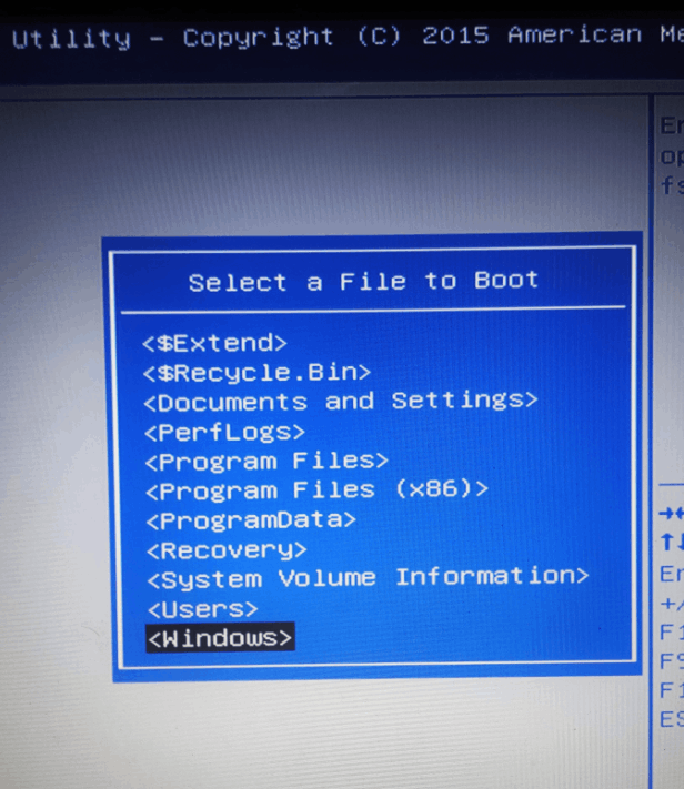

    You seem to have been unable to enter the system, can you currently enter the BIOS interface? As each brand of computer has a different method of entering the BIOS, we recommend that you ask the brand of your computer how to enter the BIOS interface. After you have successfully entered the BIOS interface, select Add New Boot Option and choose the disc where your system disc is located. See if the following menu appears.
