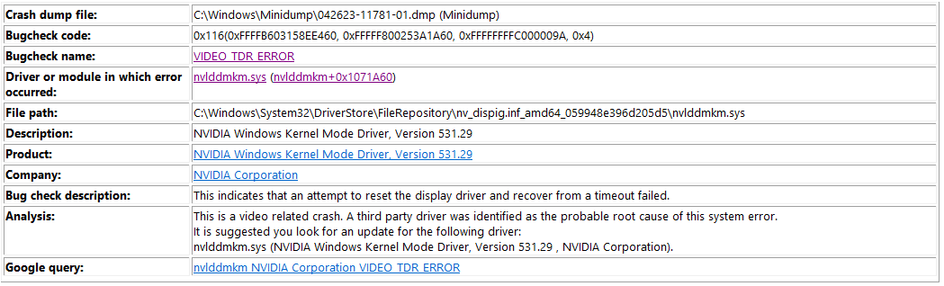

Ok so I have those error coming up in the last 4 days.
I usually can work with my pc without any problem for different hours, but randomly my pc Freeze or lost display signals and after few seconds restart.
Usually the restart goes well and I can work, again, for different hours.
Sometimes it also happens few minutes after start up, I have also started to think if a background process could eventullay cause this issue.
After the first time I've installed lasta NVIDIA drivers that didn't fix the problem, I then asked to a friend that has a similar issue and rolled back to the driver that you can see in the dump file, 531.29.

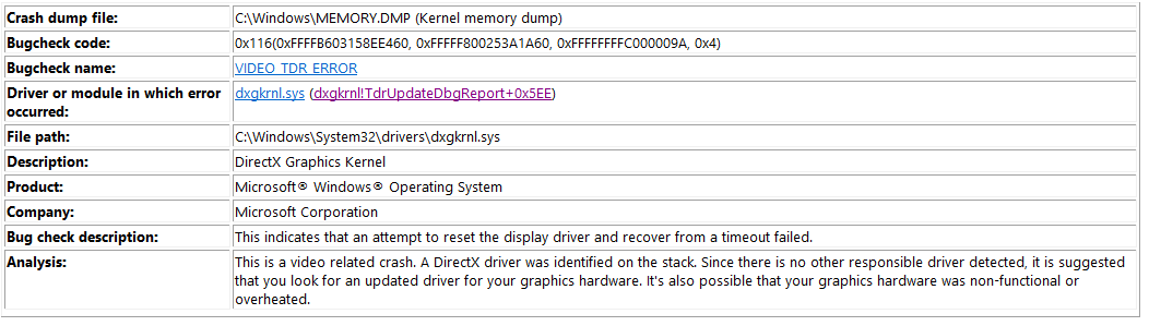

I Always get the nvlddmkm.sys error but only today I also get the dxgkrnl.sys error.
I don't know from where I can start to find a solution.
