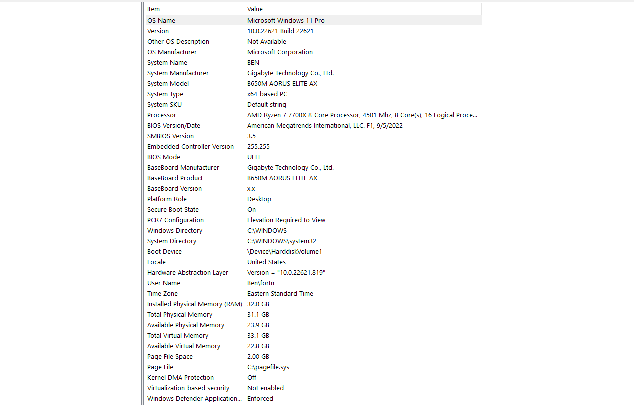

    Can you please type msinfo32.exe in the search on the taskbar and hit enter, when launched, share a screenshot please (you can paste the screenshot directly in reply).

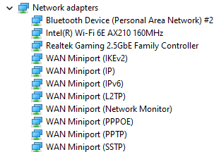

    Also, when you go to the Device Manager, can you expand Networks adapter, and share another screenshot? Thank you!

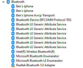

    I saw the yellow mark on the Bluetooth driver, but all it told me was it wasn't able to load the driver and gave error code 31.
  3. EmilyS726 189.2K Reputation points Independent Advisor
    2023-03-09T03:01:56+00:00
    Thank you. It is strange. Are you using some external USB Bluetooth adapter?
    Your wifi adapter also serves as bluetooth adapter, which is the Intel AX210 one. I will suggest that you right click on the realtek one and uninstall it.
    Then install the Intel BT driver. If the intel one doesn't work then try the Gigabyte link. (Intel is more generic and the gigabyte is OEM version, which has been modified to work with your board)
