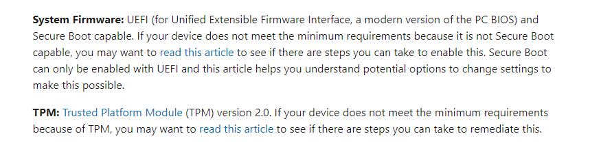

    Depending on your hardware specifications, your device should meet the minimum requirements of Windows 11, but please let me emphasize that in the requirements of Windows 11 system, it is clearly stated that the motherboard supports TPM2.0 and UEFI boot security:
