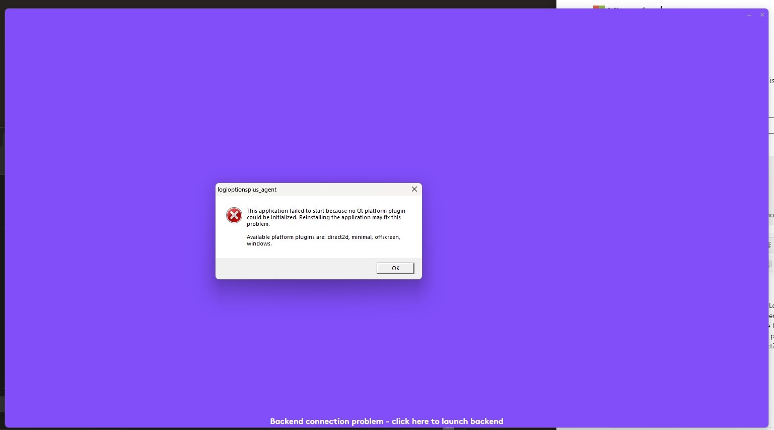

Hi there,
Since a little while ago my Windows-application "Logi Options plus" doesn't work anymore, when I try to open the application it throws the following Error: (see screenshot)
Error: "logioptionsplus_agent. This application failed to start because no Qt platform plugin could be initialized. Reinstalling the application may fix this problem. Available platform plugins are: direct2d, minimal, offscreen, windows."
  • I've tried re-installing "Logi Options plus" a few times, but that didn't resolve the Error.
  • Also, I've installed the "Qt"-application (from qt.io, latest version & "5.14.2.0") but that didn't do anything either.
  • The same application works fine on my other Windows PC, so I think some corrupt/missing Windows file must cause the problem.
  • Windows 11-version: "22H2"
I would really appreciate it if someone could help me out!

    Hi, my name is Anderson Souza, I hope I can help you with your issue.
    Do you use any third-party antivirus solutions on this PC? If so, try pausing the tool for a while and check if you can open the application.
    If the error started to occur a little while ago, it may also be that there is a restore point capable of solving the problem for you.
    This option takes your PC back to an earlier point in time, called a system restore point. Restore points are generated when you install a new app or driver, and when you create a restore point manually. Restoring won’t affect your personal files, but it will remove apps, drivers, and updates installed after the restore point was made.
    Check the steps in the corresponding topic on the link below:
    https://support.microsoft.com/windows/31ce2444-...
2 additional answers
    2023-02-20T15:37:34+00:00
    Thank you so much! The restore point feature did the trick! Thank you!
