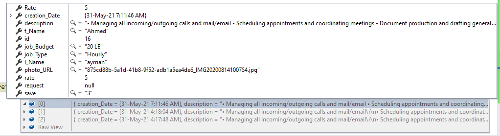

i'am getting status 500 in my asp net core code
khamis safy 1 Reputation point
2021-06-01T17:36:53.12+00:00
My ajax Code
My Action Method
My Console Response
Notice** My log didn't Printed
And The data retuened to the ajax
