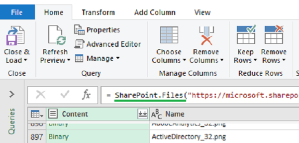

    That said, the 7th pic. (pics. don't look the same but the process is the same) in SharePoint Folder clearly shows that when you use method Get Data > From File > From Sharepoint Folder, function SharePoint.Files is used:
    and the above picture is consistent with the "From Folder" in Miguel's article Connecting to Files in SharePoint & OneDrive with Power BI / Power Query
    Later in that article he says: You can use a function by the name of SharePoint.Contents which will give you a completely new experience which looks more like a way to navigate through your folders in the event that you have way too many files
    IMHO this is exactly what you need so I would recomment you follow Miguel's article and use the SharePoint.Contents function
