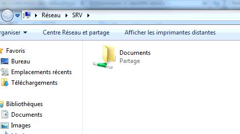

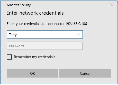

When accessing a local computer (called "SRV") from a "Client" PC, I'm asked to enter the credentials of a local account of SRV. That's OK.
Once entered, those credentials are saved somewhere in Windows in the Client PC, but I don't know where. It saves them even if I don't tick the "Save password" box.

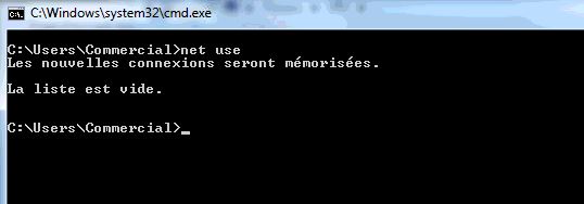

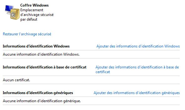

  1. Credential manager shows nothing, no credentials saved.
  2. net use * /d says "The list is empty" on Client PC.

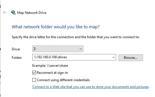

When setting up a share connection then you need to pay attention to the various options:
  • Reconnect at sign-in:
  • Remember my credentials:

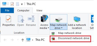

If you did not pay attention to these details then you must disconnect your existing connections:
then restore them, possibly using different credentials.

    In my case it was something I didn't expect: all the credentials of the "SRV" machine were constantly synchronised with the "Client" machine as soon as it connected to it. (for eg., I had some Chromecast and other stuff credentials to which Client PC were never connected (fresh installation of OS)).
    So even when I cleaned up the "Client" credentials, it keeped connecting to the "SRV" whithout asking anything, but as soon as I cleaned the credentials of SRV, it worked instantly on the "Client": it started asking me for credentials.
