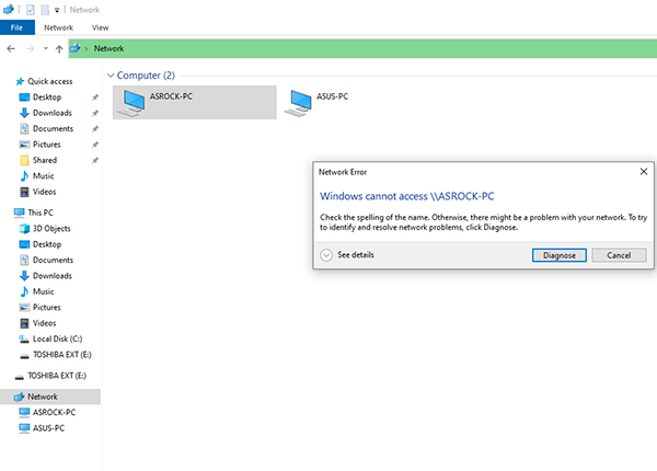

If I have Password Sharing On on PC1, and I try to open if from PC2, it tells me that the password is wrong. If I turn off the Password Sharing, it just says "Windows cannot access \PC1".
This is from PC2: (ASROCK-PC is PC1, ASUS-PC is PC2)

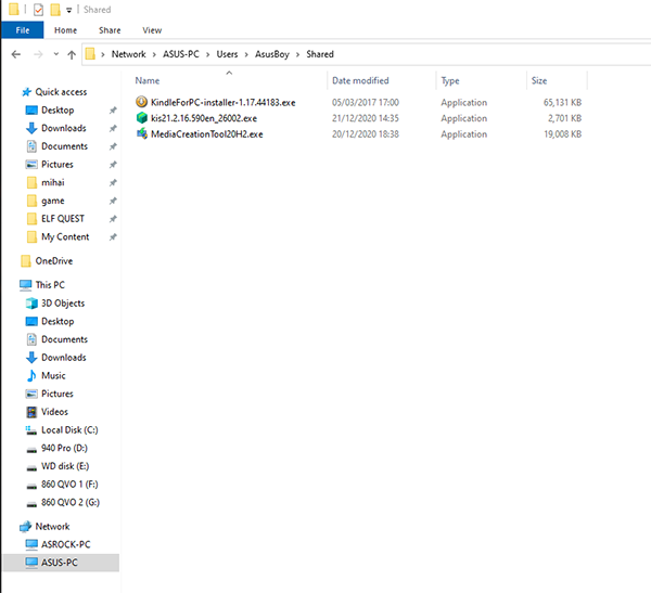

this is from PC1:
If I click Diagnose, the troubleshooter can't find the problem.
