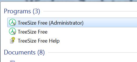

Download TreeSize Free:  https://www.jam-software.com/treesize_free
Run it "as administrator" (if the shortcut doesn't say "Administrator," then right-click the shortcut and select "Run as administrator")
