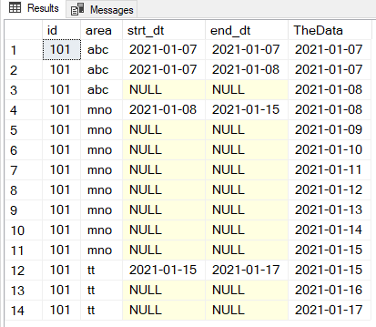

    Step 2: Now we can (guess) solve the the issue
    Basicaly, I take the rows where the area is not a null and add the missing rows
    select id, area,
     strt_dt = CASE WHEN daily_dt = TheData THEN strt_dt ELSE NULL END,
     end_dt = CASE WHEN daily_dt = TheData THEN end_dt ELSE NULL END,
     D.TheData
    from T
    LEFT JOIN Dates D ON T.strt_dt <= D.TheData and T.end_dt >= D.TheData
    where T.area is not null
    order by TheData,daily_dt,strt_dt,end_dt
    GO
    Is this fits your needs?
