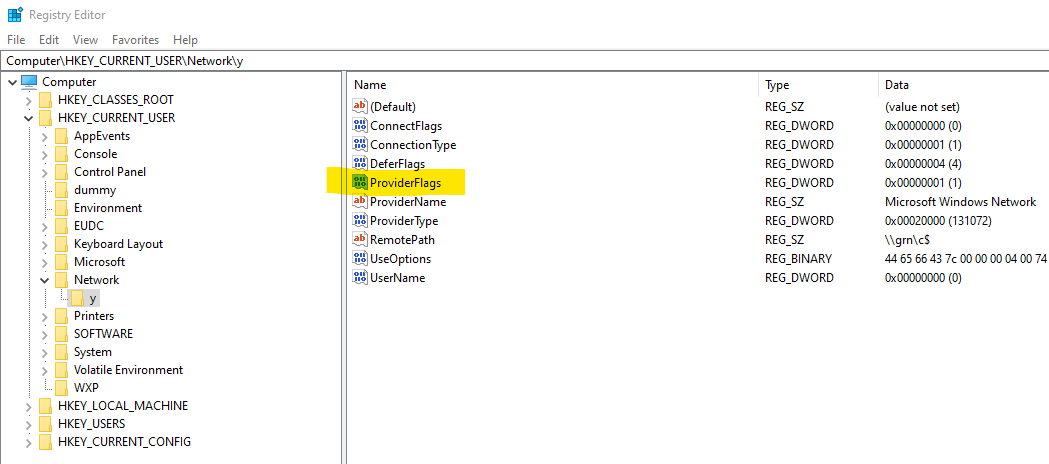

    In case that the NAS does negotiate SMBv2/3 again, there is one more thing that you can try: for each each of mapped drive letters to the Thecus N5500 stored in the registry under HKCU\Network, add a REG_DWORD value with name ProviderFlags and value 1.
    I have updated http://gary-nebbett.blogspot.com/2021/06/mapped-network-drive-reconnection.html to describe what this setting does and how it works. It is not a complete solution but it can often help.
    I found quite a few references to this workaround when researching this problem, but always without an explanation of what it did or why it helped. Having now discovered answers to those questions, I am happy to recommend it.

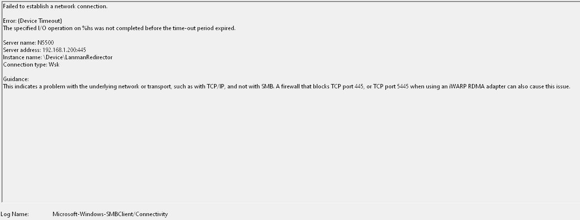

    2021-06-07T02:50:45.547+00:00
    First check SMBclient log on your windows 10 to see if there are something related for us to troubleshooting.
    If other machines have the same issue, it seems the problem is more related with NAS side. Make sure you have patched your windows 10 with fully windows updates.

    The most specific tracing that might be helpful can be performed with the commands logman start why -ets -p Microsoft-Windows-SMBClient -bs 64 -nb 999 -o why.etl and logman stop why -ets (to start and stop a trace).

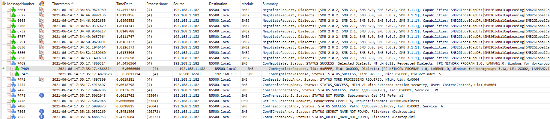

  4. Gary Nebbett 6,216 Reputation points
    2021-06-14T19:52:54.947+00:00
    Hello Josh,
    Many thanks for that trace data - it is not exactly what I expected, but at least it is not in conflict with my theory :-)
    Here is an extract:
    More or less every second, the client tries to "negotiate" a SMB2 (or higher) SMB connection, but gets no answer. Then follows a "quiet" period (no traffic), when I guess that you followed my advice to disconnect all shares to N5500 (at 17:34:53 UTC (10:34:53 by your local time)). Suddenly the client starts the negotiation with an SMB v1 offer, which (very surprisingly) is accepted.
    My theory is that a "direct" offer of SMB v2/3 will not be accepted without first offering SMBv1 - the trace seems to partially confirm this.
    The odd thing is that in this trace, the renewed protocol negotiation (at 17:35:17) completes with a negotiated version of SMB v1 (NT LM 0.12) - my theory would say that the initial offering of SMB v2/3 was only made because this version had been negotiated in the past (and it is odd that this level was not negotiated again in this trace).
