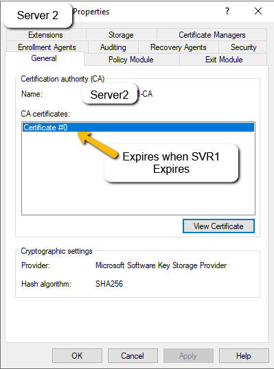

    Unfortunately I'm no further forward and not entirely confident with if it's set up correctly at all. My setup is (Viewing with MMC on Server2):
    SVR01 (SBS 2011, has everything SBS like AD etc. has we want to decommission eventually but not got around to doing it): - Old VPN (Authentication Methods: EAP-MSCHAP v2, PEAP - SSTP, which we can still access if required, tested and works still) - Holds the Templates - Certificate Authority: 105382-image.png - SVR01 Certificates (I'm sure I deleted the 2017 expired one before): 105412-image.png
    Server2 (Windows 2019, has AD and IKEv2 VPN): - VPN (Authentication Methods: EAP, MS-CHAP v2 and IKEv2). It has the VPN SSL Binding in the Personal Store that's in the bottom screenshot 'IKEv2VPN'. - Certificate Authority: 105411-image.png - Server2 Certificates: 105315-image.png
    I hope this is ok and REALLY appreciate it.
