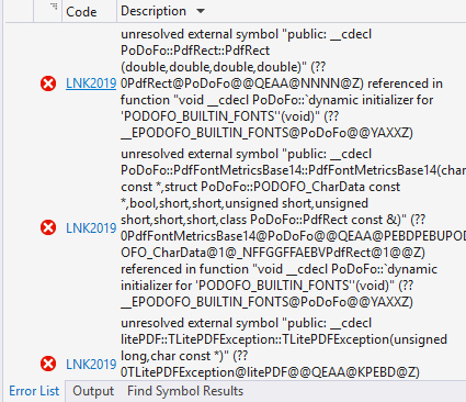

I've been reading about podofo, setting it up is quite difficult for me.
Is there any easy way in c++?
Thanks you.

    Hello,
    read the error descriptions of LNK2019:
    Functions are missing from a PoDoFo class/namespace. You must include the source of the class/namespace. podofo.sourceforge.net .
    In addition add the source for TLitePDFException to your project. index.html
    Did you try to build the examples of litePDF on the webpage?
    Since the lib is not Standard, you should ask in activity
    Regards, Guido
