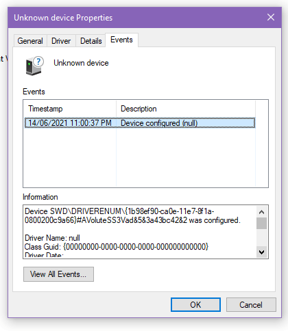

Any help finding how to fix this error? Device SWD\DRIVERENUM\{1b98ef90-ca0e-11e7-8f1a-0800200c9a66}#AVoluteSS3Vad&5&26229435&0 requires further installation.
2021-06-20T18:12:27+00:00
Hello, i’m not sure what driver it is beside it saying it was located on Realtek (R) Sound but couldn’t troubleshoot it not update it as the driver is unknown to my system.
Device SWD\DRIVERENUM{1b98ef90-ca0e-11e7-8f1a-0800200c9a66}#AVoluteSS3Vad&5&26229435&0 requires further installation.
Device SWD\DRIVERENUM{1b98ef90-ca0e-11e7-8f1a-0800200c9a66}#AVoluteSS3Vad&5&26229435&0 was configured.
Driver Name: null
Class Guid: {00000000-0000-0000-0000-000000000000}
Driver Date:
Driver Version:
Driver Provider:
Driver Section:
Driver Rank: 0x0
Matching Device Id:
Outranked Drivers:
Device Updated: false
Parent Device: HDAUDIO\FUNC_01&VEN_10EC&DEV_1220&SUBSYS_104387C4&REV_1001\4&24d869a1&0&0001

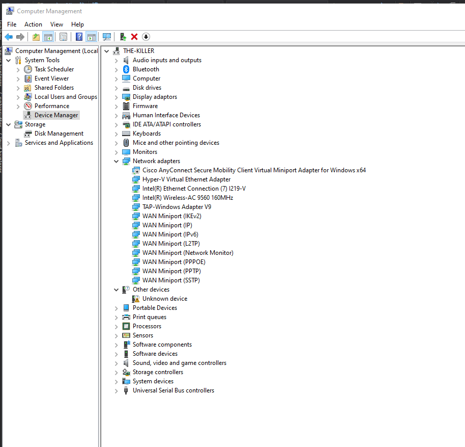

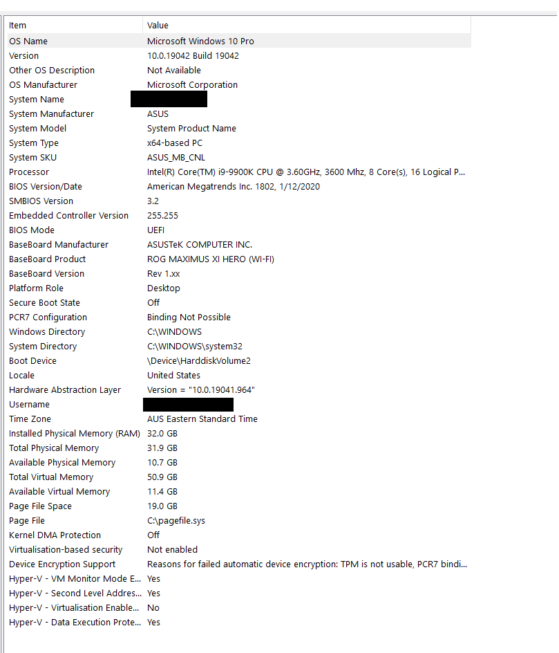

    Thank you for writing to Microsoft Community Forums.
    To get better clarity, please let us know:
    1. Are you facing any issues with sound on your computer?
    2. Do you receive any error message/code?
    3. What is the make and model of the computer?
    4. Are you aware of any changes made to the computer prior to this issue?
    5. Which build version of Windows 10 is installed on the computer? Refer Which version of Windows operating system am I running?
    It would be great if you can share a screenshot of Device Manager, so that I can have a closer look at the issue. To open Device Manager, press Windows logo key + X and select Device Manager. Please refer how to include a screenshot in your postto upload the screenshot.
    Note: Make sure you don’t capture any personal information while taking the screenshot.
    Please reply with more information on the issue to assist you further.

    2021-06-24T15:05:17+00:00
    I can confirm I am experiencing the same issue with the following details:
    I do not appear to have any issues with my system sound
    Device SWD\DRIVERENUM{1b98ef90-ca0e-11e7-8f1a-0800200c9a66}#AVoluteSS3Vad&5&3a43bc42&2 was configured.
    Driver Name: null
    Driver Date:
    Driver Version:
    Driver Provider:
    Driver Section:
    Driver Rank: 0x0
    Matching Device Id:
    Outranked Drivers:
    Parent Device: HDAUDIO\FUNC_01&VEN_10EC&DEV_1220&SUBSYS_10438735&REV_1001\4&287b1049&0&0001
