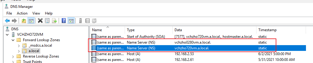

    3.Check if primary domain controller and secondary domain controller are all DNS server (I mean check if you install and configure DNS role on both DCs).
    Or check if there is NS record for both DCs in the DNS manager.

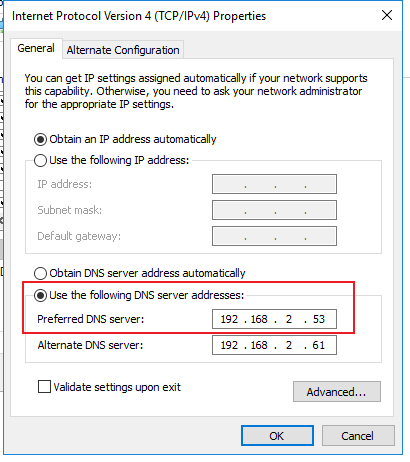

    4.Check if you set the correct preferred DNS server on WSUS server (Please double check here, no one number can be wrong ).
    For example:
