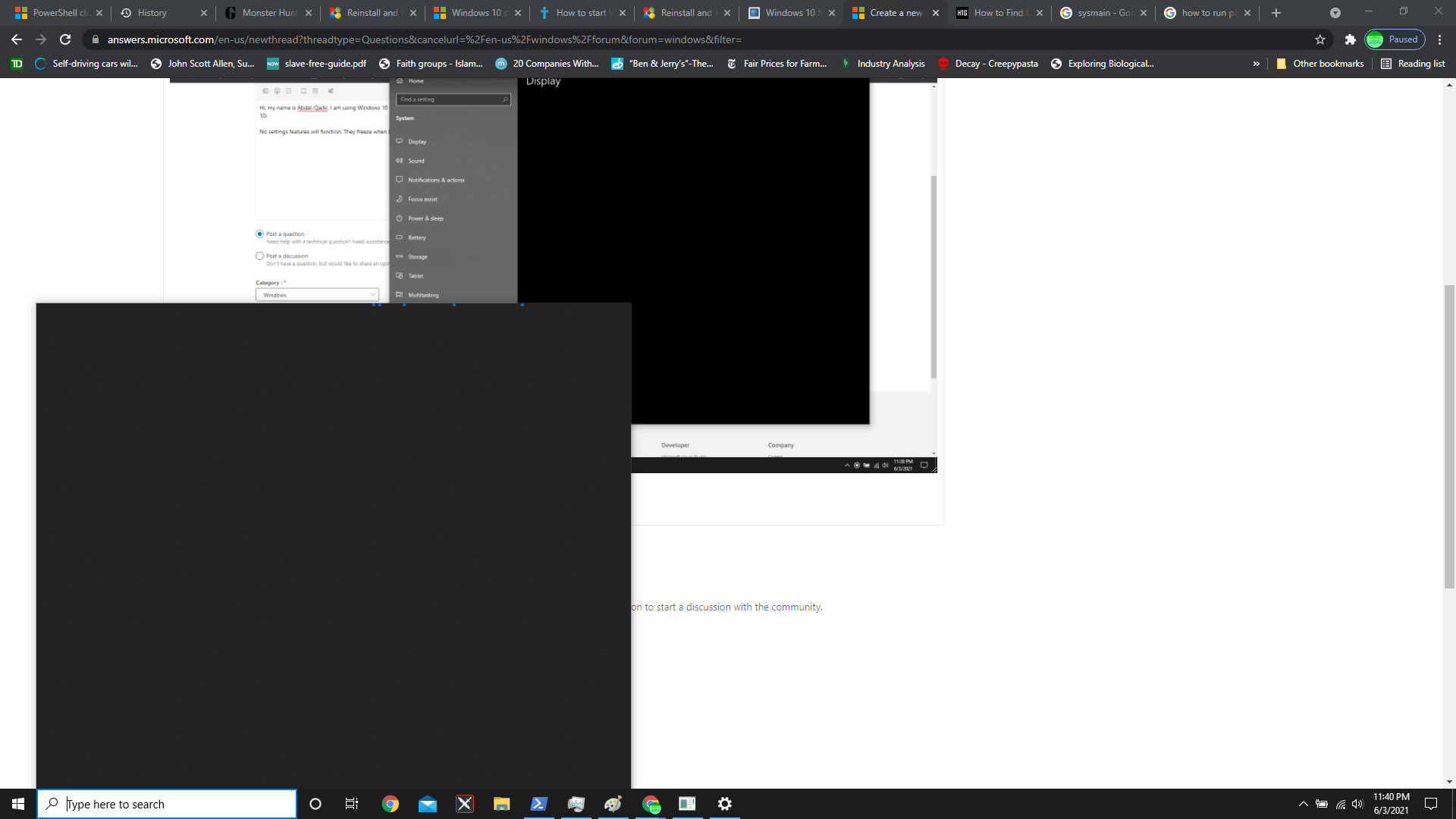

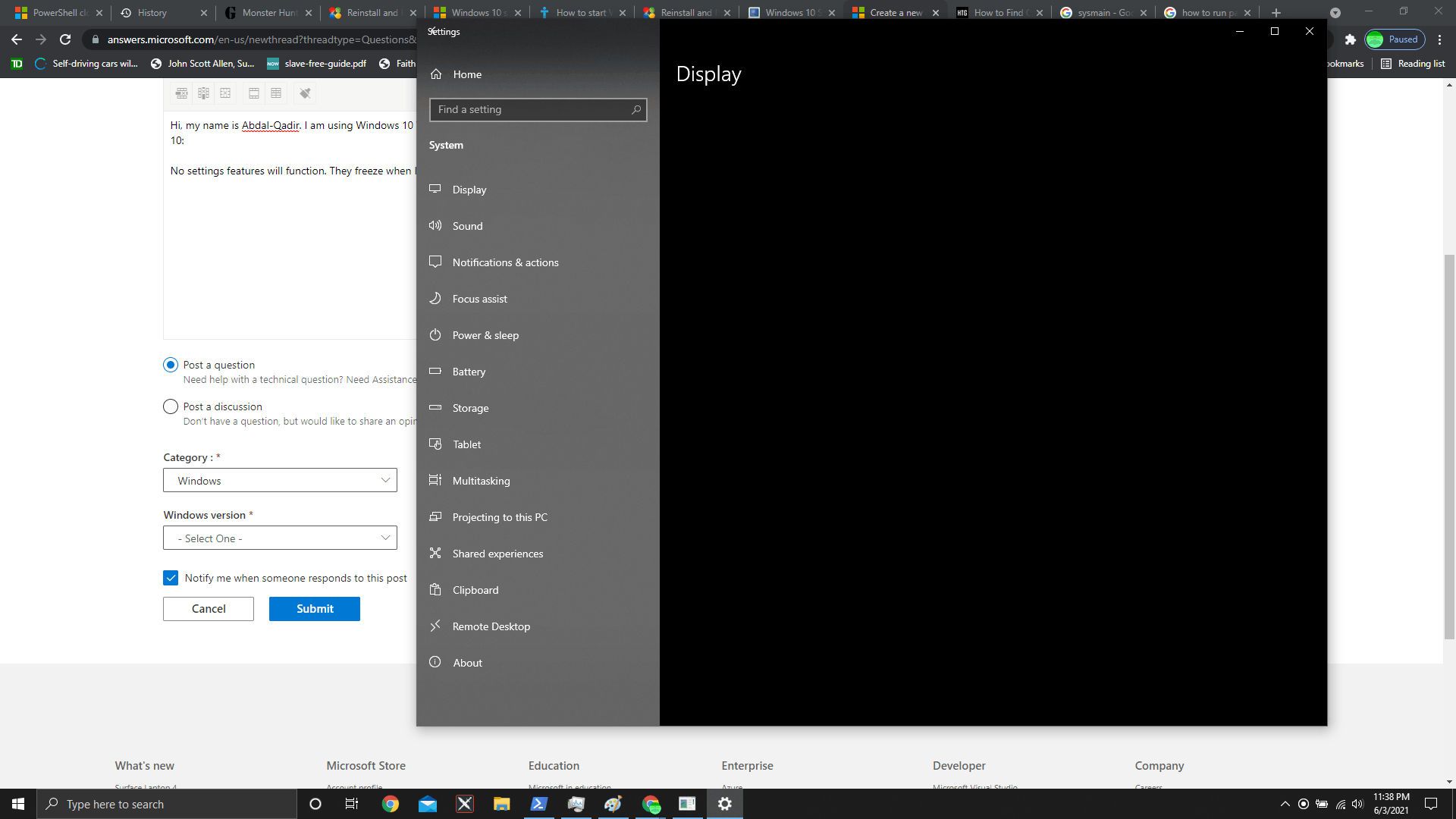

No settings features will function. They freeze when I open them and none of the tabs under System are clickable. I also cannot back out to the main settings menu. Screenshot:

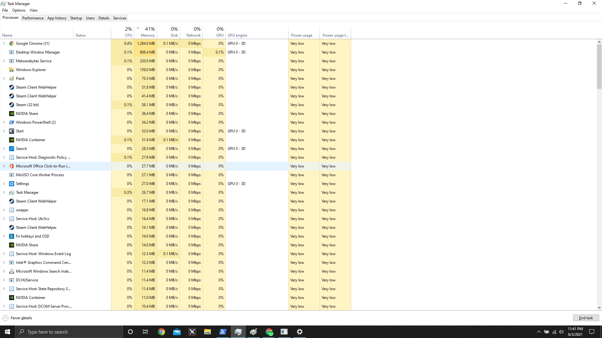

My Malwarebytes application does not show up even though the process is present, this is also the case with other applications: Zoom, Monster Hunter: World (a Steam game), but not Steam itself, which is open and works. Webex works. A game emulator I have opens and runs. But others like Malwarebytes do not. Screenshot:

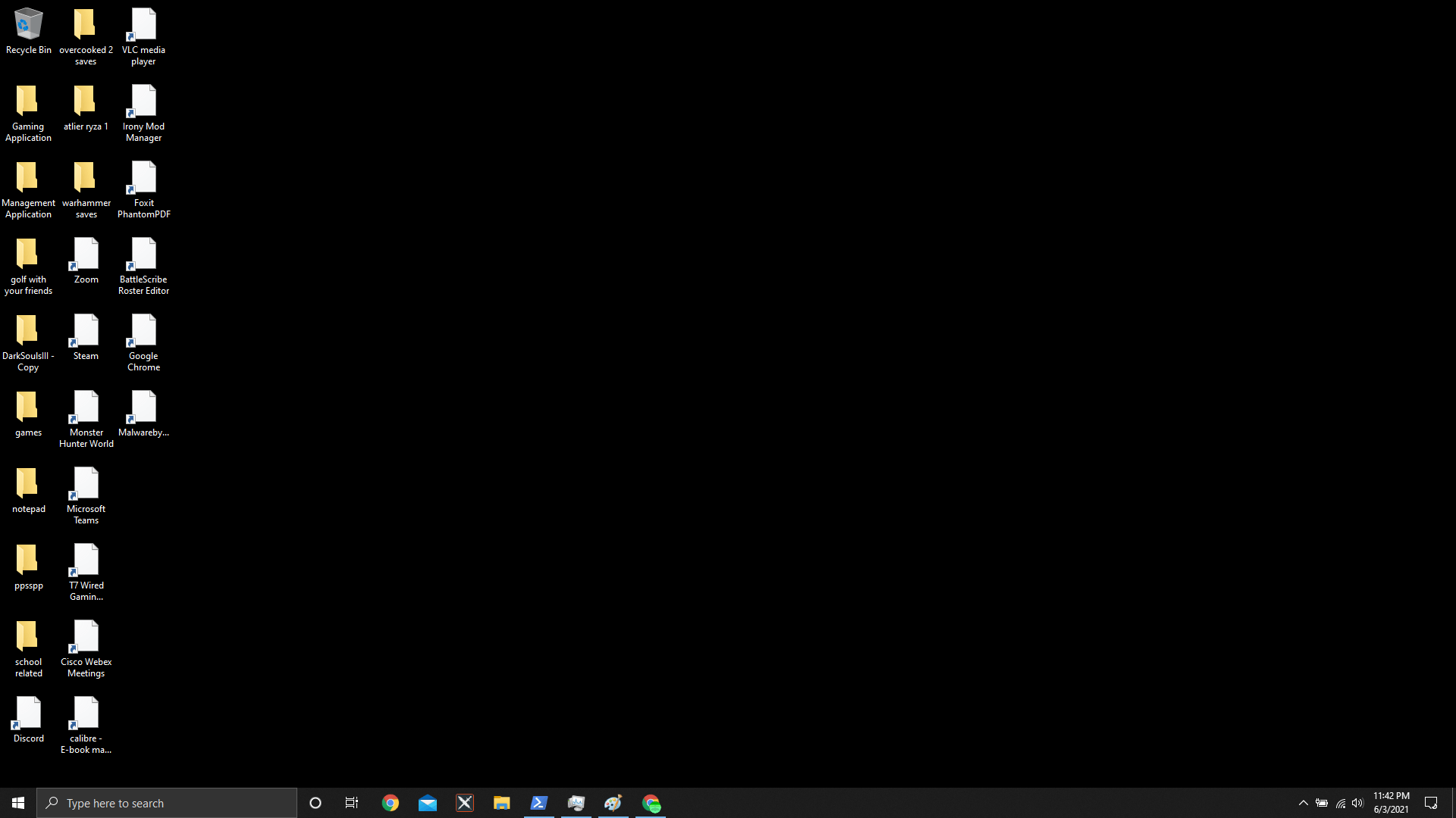

None of my desktop icons will load:
I cannot press the bottom right of the screen to see the desktop either, although this changes sometimes.

    I cannot access Apps and Features, because every item in Settings freezes when I open it, and for some reason, when I restart in Safe Mode with Networking, I cannot look at any of the available networks.
