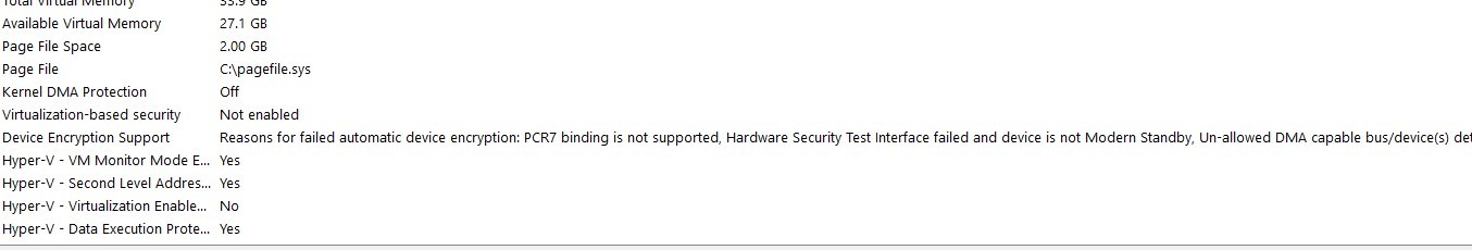

Could someone let me know why I am getting the following message in System Information please?
Device Encryption Support: Reasons for failed automatic device encryption: Hardware Security Test Interface failed and the device is not Modern Standby, Un-allowed DMA-capable bus/device(s) detected
I am using Windows 11 Pro on a Ryzen 3900x system. I have bitlocker turned on and memory Integrity is enabled. Other security features are as per Windows 11 requirements.
Does this message mean I am missing security features and my PC isn’t as secure as it could/ should be?
Any clarity would be appreciated.

    Because you are running msinfo32.exe as admin. It shows up on all systems when run that way.

    I was viewing it as an admin. Thanks very much.
    If viewed without admin privileges, it says 'Elevation required to view'. Does this mean it is impossible to see the Device Encryption Support status?
