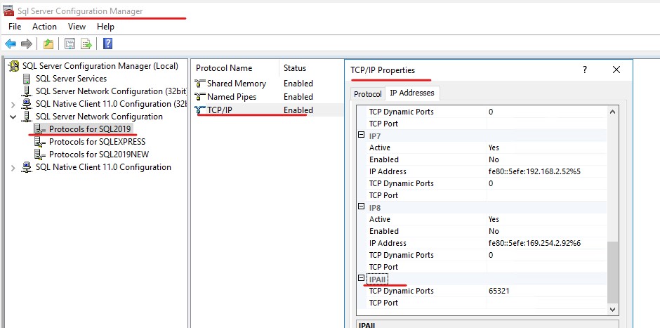

  1. CathyJi-MSFT 22,401 Reputation points Microsoft External Staff
    2021-06-08T08:23:09.887+00:00
    Hi @Stefan Vogel ,
    Please check your SQL server port from error log or SQL server configure manager as below screenshot. This is a fixed port or dynamic port?
    If it is not work, please check below steps,
    1. If a named instance, make sure SQL Server browser service is running. Make sure the instance name is spelled correct and there is actually such an instance on your target machine.
    2. Test server connectivity with PING from the client machine
    3. Test port connectivity using TELNET to the server and port (from step 4) from the client machine. For example
      TELNET <server-name> 1433
    4. Check firewall settings if step 2or 3 connectivity test fails

  3. Erland Sommarskog 128.7K Reputation points MVP Volunteer Moderator
    2021-06-07T21:33:33.777+00:00
    Is SQL Server actually listening on port 1433? It seems that it is a named instance, so by default it would be using some other port.
    If you supply the instance name, keep in mind that you need to open port UDP 1434 in the firewall, for the Browser service to be available.
