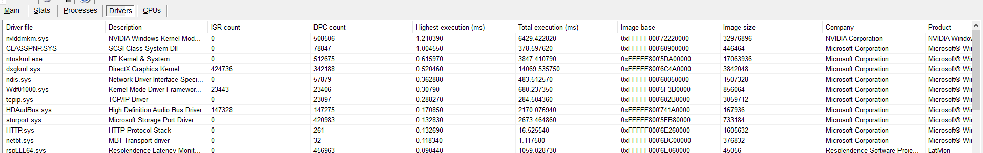

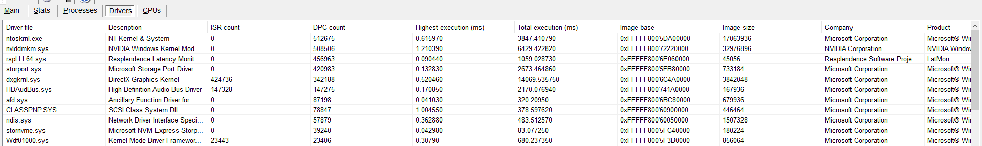

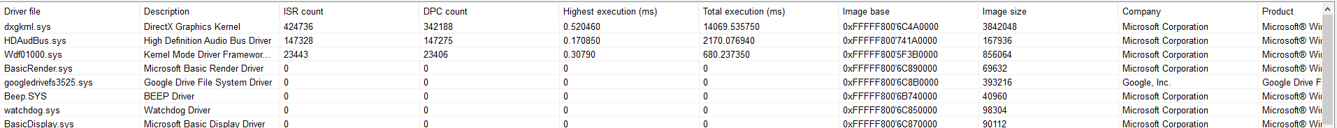

Hello, sometimes mouse input stuttering, i've change with another mouse but still same. this is not mouse problem i think but my driver. i do clean the display driver, change nvidia driver version but nothing changed still struggling with this stuttering.
i run latencymon and this is the result, any ideas whats going on?
_________________________________________________________________________________________________________
CONCLUSION
Your system seems to be having difficulty handling real-time audio and other tasks. You may experience drop outs, clicks or pops due to buffer underruns. One or more DPC routines that belong to a driver running in your system appear to be executing for too long. One problem may be related to power management, disable CPU throttling settings in Control Panel and BIOS setup. Check for BIOS updates.
LatencyMon has been analyzing your system for 1:11:41 (h:mm:ss) on all processors.
SYSTEM INFORMATION
Computer name: XXXXX
OS version: Windows 10, 10.0, version 2009, build: 19043 (x64)
Hardware: MS-7B93, Micro-Star International Co., Ltd.
CPU: AuthenticAMD AMD Ryzen 9 3900X 12-Core Processor
Logical processors: 24
Processor groups: 1
RAM: 32689 MB total
CPU SPEED
Reported CPU speed: 380 MHz
Note: reported execution times may be calculated based on a fixed reported CPU speed. Disable variable speed settings like Intel Speed Step and AMD Cool N Quiet in the BIOS setup for more accurate results.
MEASURED INTERRUPT TO USER PROCESS LATENCIES
The interrupt to process latency reflects the measured interval that a usermode process needed to respond to a hardware request from the moment the interrupt service routine started execution. This includes the scheduling and execution of a DPC routine, the signaling of an event and the waking up of a usermode thread from an idle wait state in response to that event.
Highest measured interrupt to process latency (µs): 635.30
Average measured interrupt to process latency (µs): 26.750170
Highest measured interrupt to DPC latency (µs): 611.0
Average measured interrupt to DPC latency (µs): 2.026997
REPORTED ISRs
Interrupt service routines are routines installed by the OS and device drivers that execute in response to a hardware interrupt signal.
Highest ISR routine execution time (µs): 248.70
Driver with highest ISR routine execution time: dxgkrnl.sys - DirectX Graphics Kernel, Microsoft Corporation
Highest reported total ISR routine time (%): 0.009798
Driver with highest ISR total time: dxgkrnl.sys - DirectX Graphics Kernel, Microsoft Corporation
Total time spent in ISRs (%) 0.011432
ISR count (execution time <250 µs): 595507
ISR count (execution time 250-500 µs): 0
ISR count (execution time 500-1000 µs): 0
ISR count (execution time 1000-2000 µs): 0
ISR count (execution time 2000-4000 µs): 0
ISR count (execution time >=4000 µs): 0
REPORTED DPCs
DPC routines are part of the interrupt servicing dispatch mechanism and disable the possibility for a process to utilize the CPU while it is interrupted until the DPC has finished execution.
Highest DPC routine execution time (µs): 1210.390
Driver with highest DPC routine execution time: nvlddmkm.sys - NVIDIA Windows Kernel Mode Driver, Version 456.71 , NVIDIA Corporation
Highest reported total DPC routine time (%): 0.004791
Driver with highest DPC total execution time: nvlddmkm.sys - NVIDIA Windows Kernel Mode Driver, Version 456.71 , NVIDIA Corporation
Total time spent in DPCs (%) 0.020101
DPC count (execution time <250 µs): 2712262
DPC count (execution time 250-500 µs): 0
DPC count (execution time 500-10000 µs): 1187
DPC count (execution time 1000-2000 µs): 5
DPC count (execution time 2000-4000 µs): 0
DPC count (execution time >=4000 µs): 0
REPORTED HARD PAGEFAULTS
Hard pagefaults are events that get triggered by making use of virtual memory that is not resident in RAM but backed by a memory mapped file on disk. The process of resolving the hard pagefault requires reading in the memory from disk while the process is interrupted and blocked from execution.
NOTE: some processes were hit by hard pagefaults. If these were programs producing audio, they are likely to interrupt the audio stream resulting in dropouts, clicks and pops. Check the Processes tab to see which programs were hit.
Process with highest pagefault count: system
Total number of hard pagefaults 80942
Hard pagefault count of hardest hit process: 27273
Number of processes hit: 93
