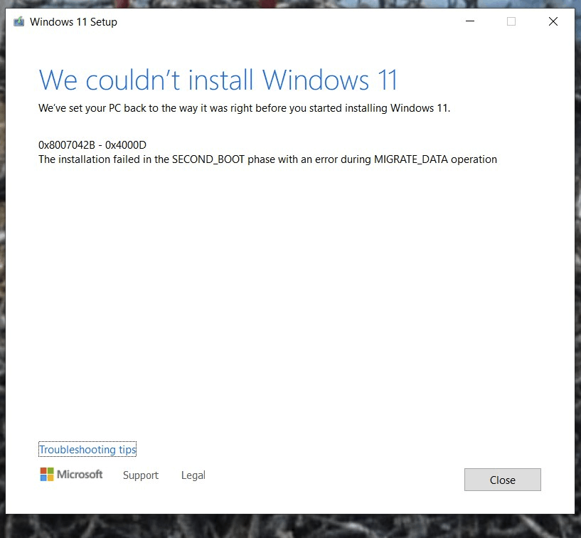

Any help with resoving this would be much appreciated:-
Matching Profile found: FindFatalPluginFailure - E48E3F1C-26F6-4AFB-859B-BF637DA49636
SetupDiag version: 1.6.0.0
System Information:
               Machine Name = OFFICE-64
               Manufacturer = Gigabyte Technology Co., Ltd.
               Model = AB350-Gaming
               HostOSArchitecture = 2057
               FirmwareType = UEFI
               BiosReleaseDate = 20200702000000.000000+000
               BiosVendor =
               BiosVersion = F50d
               HostOSVersion =
               HostOSBuildString = 18362.1.amd64fre.19h1_release.190318-1202
               TargetOSBuildString = 10.0.22000.194 (co_release_svc_prod1.210911-1543)
               HostOSLanguageId =
               HostOSEdition = Professional
               RegisteredAV = Bitdefender Antivirus
               FilterDrivers = FileInfo
               UpgradeStartTime = 20/10/2021 21:19:49
               UpgradeEndTime = 20/10/2021 23:54:15
               UpgradeElapsedTime = 02:34:26
               CV = m7rr06KbIEW/s0Hu
               ReportId =
Error: SetupDiag reports fatal migration plug-in failure.
Last Phase: Pre OOBE Boot
Last Operation: Machine-independent apply
Plug-in Name = Microsoft-Windows-AppX-Deployment-Server\AppxUpgradeMigrationPlugin.dll
Migration Operation = IPostApply->ApplySuccess
Plug-in Error: 0x80010105
Refer to "https://docs.microsoft.com/en-us/windows/desktop/Debug/system-error-codes" for error information.
Last Setup Phase:
Phase Name: Pre OOBE Boot
               Phase Started: 20/10/2021 22:37:49
               Phase Ended: 01/01/0001 00:00:00
               Phase Time Delta: 00:00:00
               Completed Successfully? False
Last Setup Operation:
Operation Name: Machine-independent apply
               Operation Started: 20/10/2021 22:38:41
               Operation Ended: 01/01/0001 00:00:00
               Operation Time Delta: 0:00:00:00.0000000
Thanks
Adrian

    It is hard to evaluate something like you are seeing without the files setuperr.log and setupact.log which are in the C:$Windows.~BT \Sources\Panther folder. Even with those, if something is happening while the system is working offline, the problem may not even be written to the logs..
    2021-10-21T18:37:44+00:00
    Thanks for this.
    I have tried about 10 times after the usual fixes of stripping back to bare motherboard, clean install via msconfig, SFC & Restore Health etc and I always get the same error message as below. The error report is from processing the update logs with Setupdiag.exe. Currently checking if there is an option just to include apps as part of upgrade and attach personal files later? Quite desperate to avoid having to attempt to transfer registration codes for expensive apps after a new install.
    Thanks Again
    Adrian

    Hi Adrian. I'm Greg, 10 years awarded Windows MVP, specializing in Installation, Performance, Troubleshooting and Activation, here to help you.
    Do you mean that this is a failure of Windows 11 Upgrade? How far into the Upgrade process does it occur? Please clarify exactly what you are trying to do and when the error appears.
    Try these fixes:
