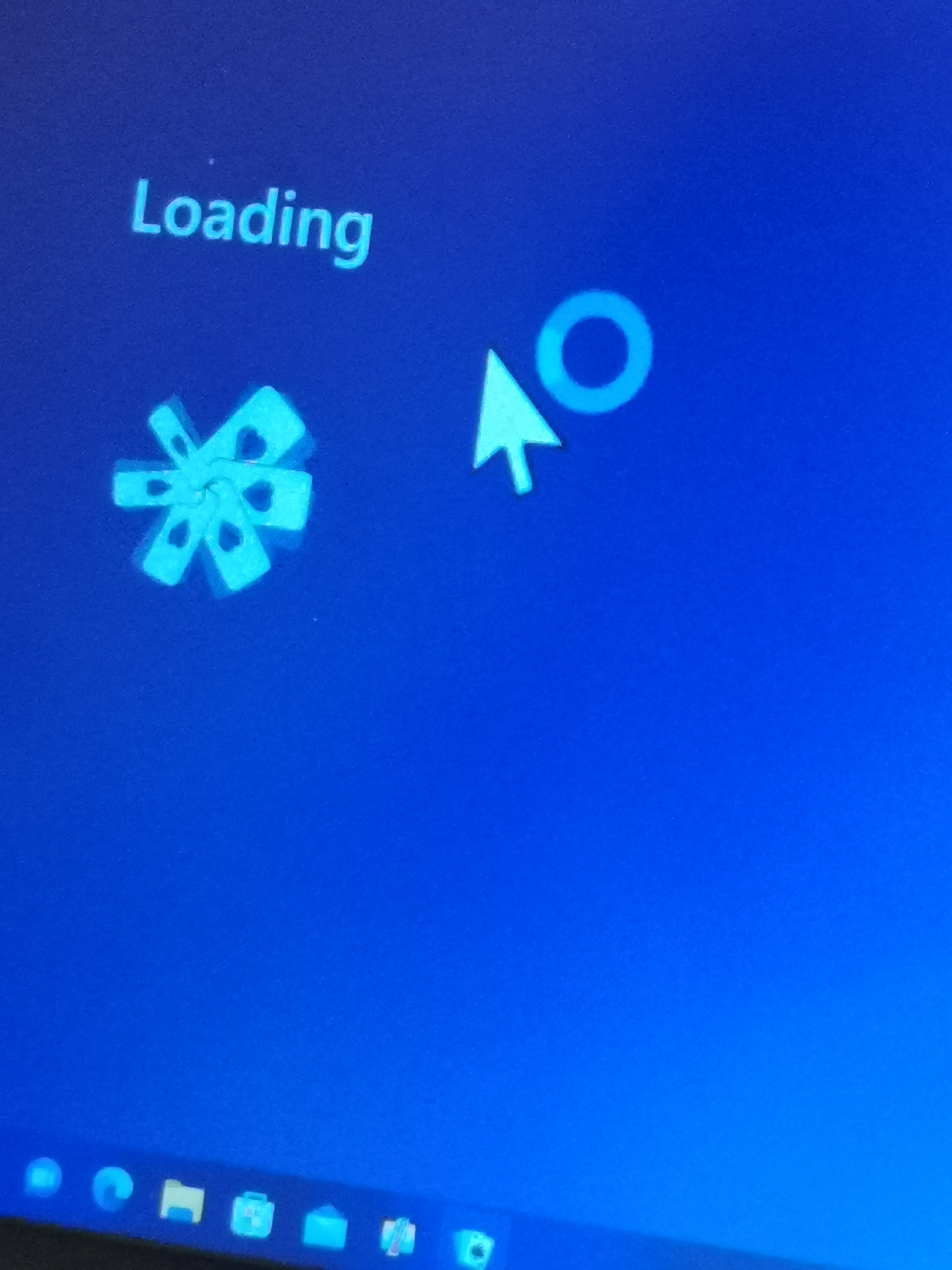

hi. just upgraded to windows 11 on my laptop. my mouse pointer has been fine in windows 10 and the busy blue circle fine too. since moving to 11. my laptop is idle nothing going on. yet the white mouse pointer keeps flickering and the blue circle with it. can someone tell me how to correct this. very annoying as it keeps getting my eyes looking at it. thank for any replies to this problem.
UPDATE: i have just uploaded the cursor and blue circle i am talking about. as its a photo you cannot see it flickering.
regards

    2021-10-11T19:16:47+00:00
    hello Vineet Kumar
    thank you for your reply.
    the laptop is a HP . The model of the laptop is 17-BY0000NA
    the issue with the mouse cursor flickering happens when windows 11 gas logged in. it is idle with NO programs launched. it continues to happen whenever i am using the laptop. it doesn't go away. very distracting on the eyes.
    i will try the method 1 then 2 all the way to a clean boot method 3. will let you know if it changes.
