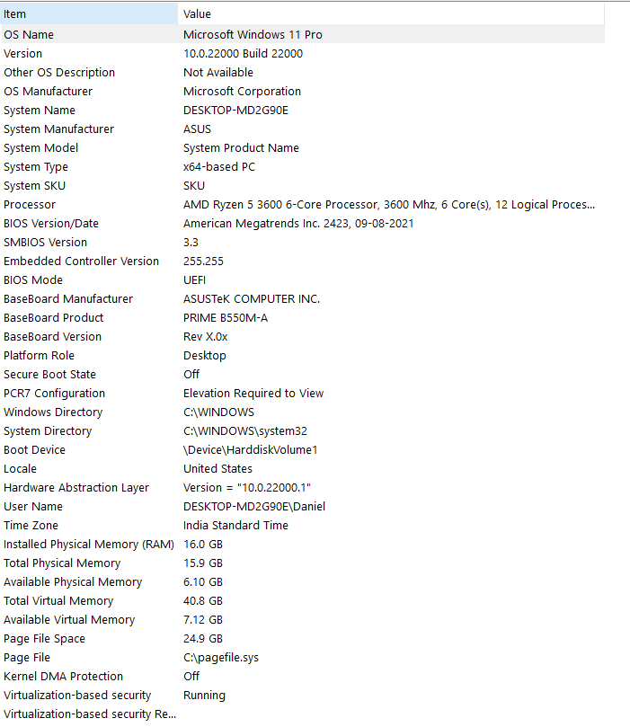

    1
    What method did you use to upgrade to Windows 11, that should not have been possible if Secure Boot was disabled.
    2
    I need more information about your system,
    Click your Start Button, then just type msinfo and press Enter
    Please provide a screenshot of the resulting System Information window.

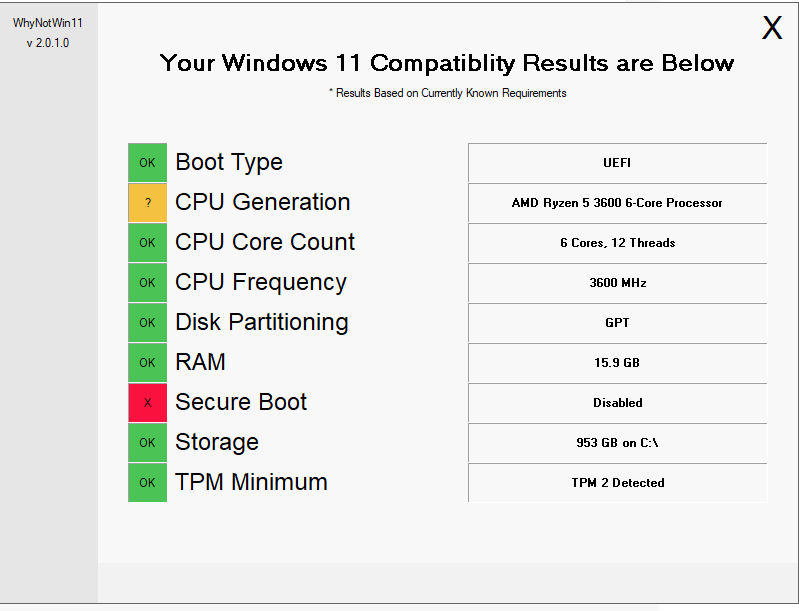

    3
    Download the tiny utility from the link below, then run that utility and please provide a screenshot of the result of tunning that scan
    https://github.com/rcmaehl/WhyNotWin11/releases...
