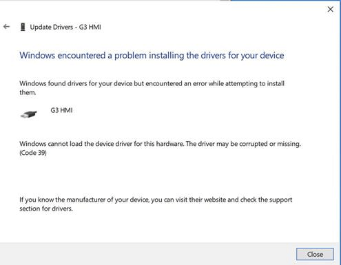

I have a USB device which is not installing the driver correctly. It displays with the yellow exclamation point as shown below.
According to the manufacturer's document, I can navigate to the driver and manually install. When I do that I get the following:
I know the driver I am trying to install works on Windows 10 because I am copying the driver directly from another PC that is able to connect to the device.

    RedLion Tech support came through with this:
    The below fixed customers issue new PC USB driver error code 39.
    If Windows shows the following error ”Windows cannot load the device driver for this hardware. The driver may be corrupted or missing. (Code 39) {Bad Image} %hs is either not designed to run on Windows or it contains an error. Try installing the program again using the original installation media or contact your system administrator or the software vendor for support. Error status 0x “
    I was not sure how to actually change the value, but you need to click on the Dword portion to actually change it.
    Open the registry editor by typing in regedit on your Windows 10 search bar and change the Enabled value of *HKEY_LOCAL_MACHINE\SYSTEM\CurrentControlSet\Control\DeviceGuard*
    Scenarios\HypervisorEnforcedCodeIntegrity is set to 0.
    Restart your PC after you do this and that should hopefully take care of it.
