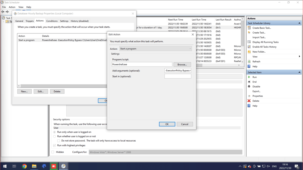

Hi there, I have created a .ps1 file which contains a RoboCopy script to copy files from a folder on my C: drive which contains a database, and paste them into a folder on my OneDrive so that they can be safely backed up to the cloud and have a history of changes.
The code runs perfectly fine when executed manually (By right-clicking the file in File Explorer and selecting 'Run with Powershell'), the problem is that the backup needs to happen on a regular basis, hourly is ideal, so I created a task inside of Task Scheduler to repeat the task every hour. The task itself runs fine (I tested this by changing what the action is when the task is triggered to open a program instead).
The problem is that when I change the action to run Powershell and add the path of my file under the 'Add Arguments' section, the task does not work. The task still runs, Powershell loads, but then immediately closes and does nothing, however running the exact same file manually will work just fine.
I have tried adding '-File'; '-Command'; 'ExecutionPolicy Bypass' and '-ExecutionPolicy Unrestricted' before the path of my file, but nothing happened.
Am I doing something wrong or is there a setting that needs to be changed? I have done some research and found that it could possibly have something to do with the execution policy, I tried several things related to that (not sure if I did the right thing or if I did it right) but none of them seemed to work.

    Pls try this syntax:
    • powershell.exe -noprofile -executionpolicy bypass -NoExit -File d:\myscript.ps1
    The "-NoExit" argument will keep the PS window open. That way, you can know if an error was generated.

    THANK YOU SO MUCH
    The '-NoExit' helped give me the error and I fixed the issue!
    I can't thank you enough!
