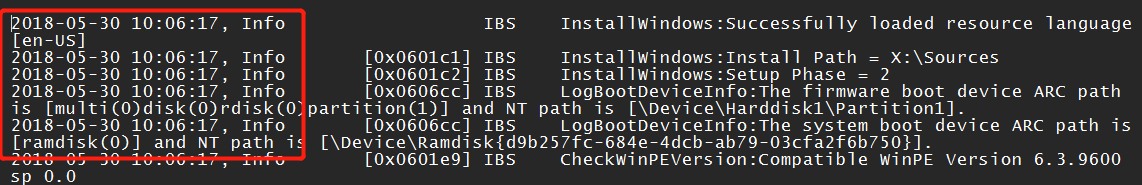

After observation, it seems that this setup log is the update log in 2018. did you see other recent update log in this path?
