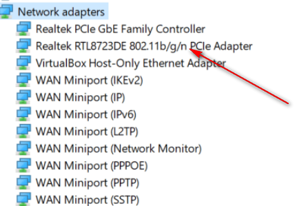

  1. DaveM121 891.1K Reputation points Independent Advisor
    2022-12-16T07:58:14+00:00
    Hi KAryaman,
    It is the device shown below, when you previously re-installed that driver, did you download the recommended version for the support page for your PC?
  2. DaveM121 891.1K Reputation points Independent Advisor
    2022-12-15T16:18:00+00:00
    Hi KAryaman,
    Your minidump files indicate it is the device driver on the Realtek network card that is causing the system to crash.
    Go to the support page for your PC on the manufacturers website, then from there, download and install the version of Realtek network (WLAN) card device drivers they recommend.

    2022-12-15T16:44:43+00:00
    I just downloaded and installed it ,but nothing happened same problem is coming.
