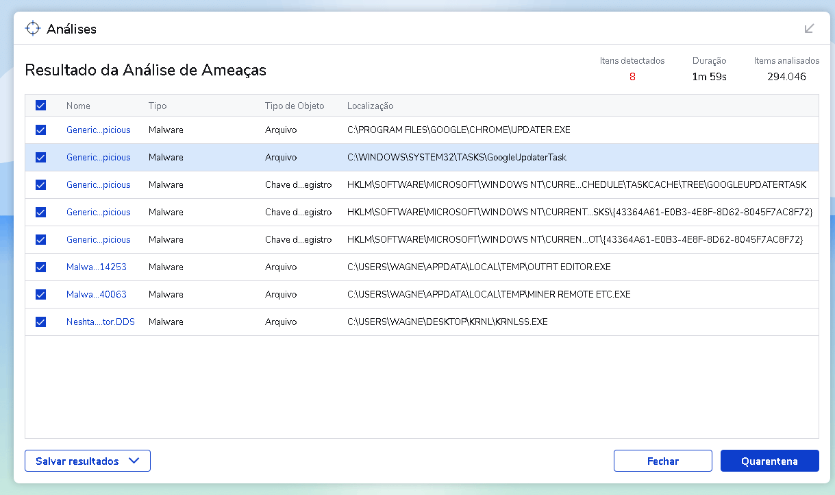

_AW_ 67,926 Reputation points Volunteer Moderator
2023-01-20T11:44:28+00:00
Download Fixlist.txt from the link below to the same folder that FRST is in, then run FRST and press the Fix button.
FRST will restart the computer when it finishes processing the script.
Please post the resulting Fixlog from your Downloads directory and let me know if any problems remain.
https://1drv.ms/t/s!AqQnVFhmcB_wmFqsvXcnSNrStrqJ?e=tic9dP

  2. _AW_ 67,926 Reputation points Volunteer Moderator
    2023-01-19T22:59:48+00:00
    Quarantine everything that has been detected. Then restart the computer.
    2023-01-19T22:09:52+00:00
    What i do?
  4. _AW_ 67,926 Reputation points Volunteer Moderator
    2023-01-19T21:50:05+00:00
    Hi Oniii-Chan, sounds like you may have a miner running. I suggest you scan with Malwarebytes:
    https://www.malwarebytes.com/mwb-download
    Let me know the result.
