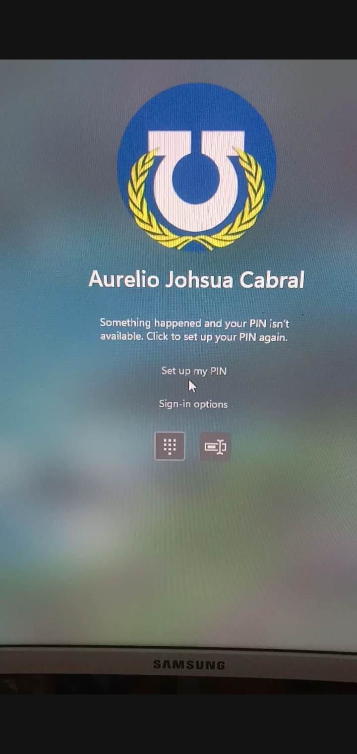

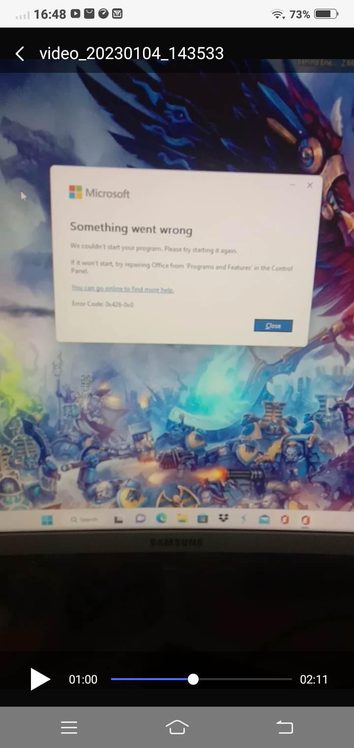

For some odd reason, my internet connection was suddenly lost even though we have a good connection. As I went deeper to see what's going on, I also found out that my Bluetooth, Speakers, Microsoft Apps, (Word, Ppoint, Excel, Teams) Insert Flash drives are also inaccessible. I also can't open my PC using my own PIN after this incident. I also tried opening the firewall and it says;

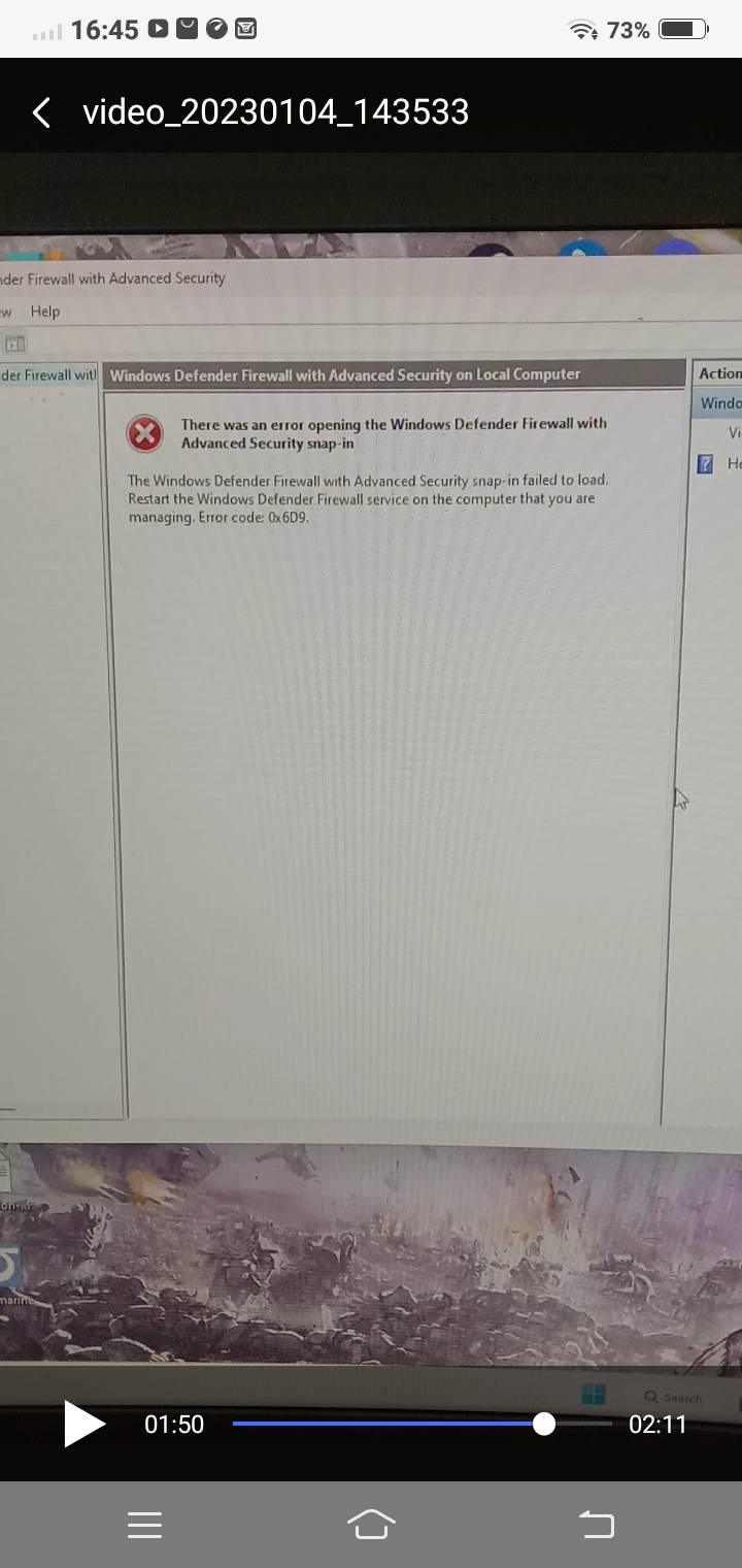

"There was an error opening the Windows Defender Firewall with Advanced Security Snap-in"
There is also an Error Code 0x 6D9

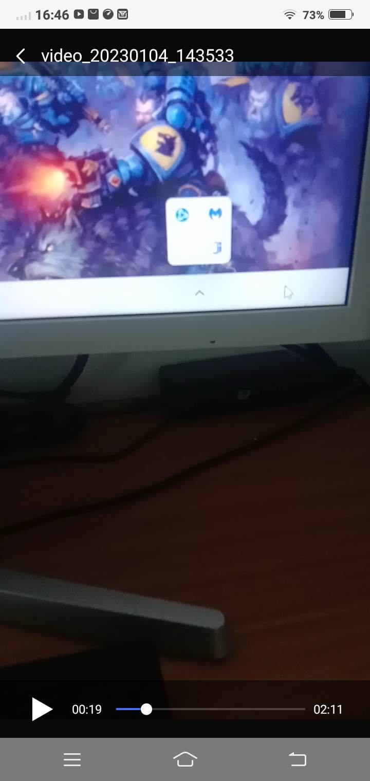

On the bottom right screen, I can no longer see the date, time, wifi access, sounds etc. My widget and forecast are also disabled.
