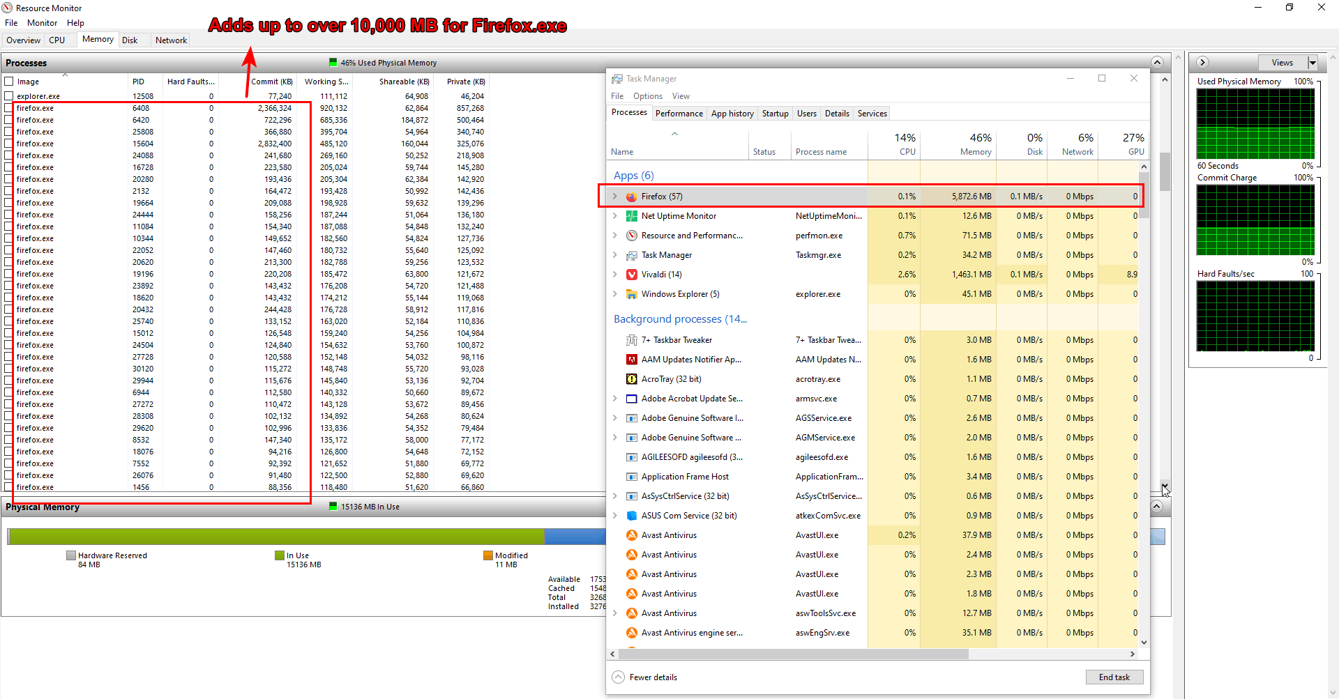

I found something curious in the Resource Monitor, which seems to show a lot more detail than the task manager. It reports 4 different memory types for a given executable: Commit, Working Set, Shareable, and Private.
I have no idea what each one means, but from a quick calculation it seems like the Commit memory is the largest one when you add it up and it seems to be much closer to the total memory shown in the Performance tab of the task manager, and it's much higher than the one in the Processes tab.
So I would just refer to the Resource Manager to see how much memory an application is really using, because the task manager values under Processes or User tabs are not very useful. I think those correspond to the "Working Set" values in Resource Manager.
If anyone has any insights, please do share. All I want is an easy way to tell how much memory each of my applications are really using.
Resource Manager helps, but the downside is that when the application has dozens of individual processes like FIrefox, and requires adding them up manually, because it doesn't seem able to 'lump' them up and show the total for that application like the task manager can.

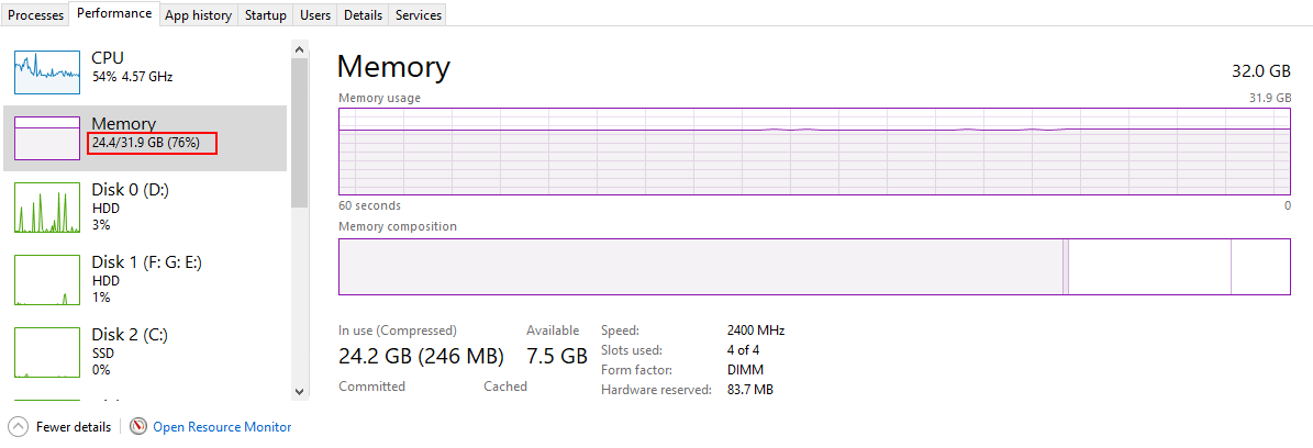

    For example, here I see 24.4/31.9 GB total memory usage (whatever types of memory that may consist of is not strictly important to me).

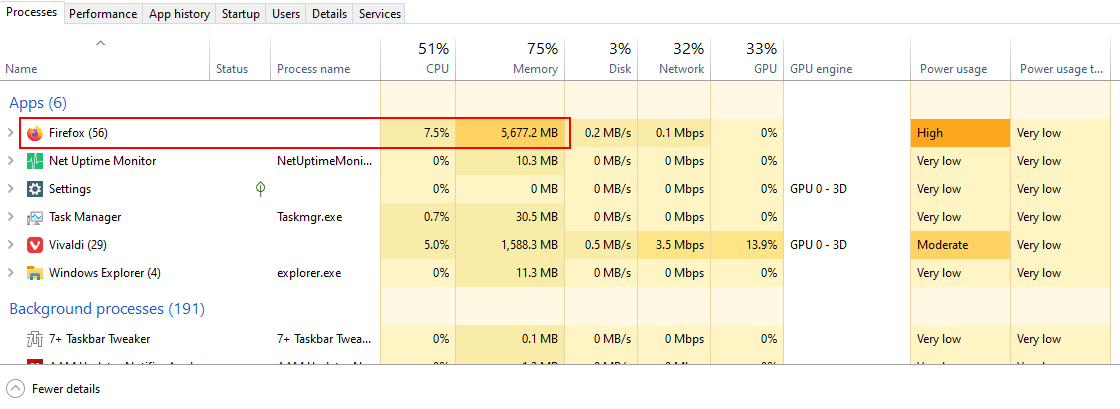

    In the Processes tab, I see that Firefox supposedly uses about 5.7 GB

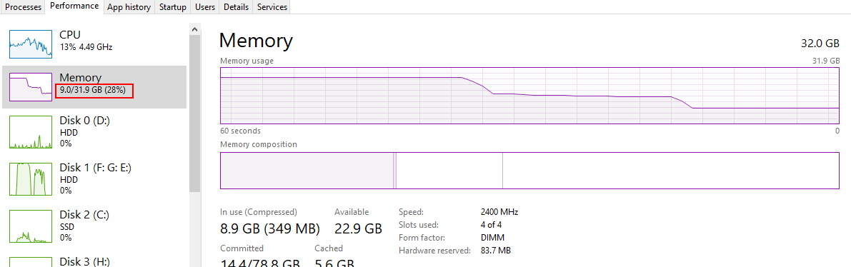

    Instead, my used memory drops to 9 GB !
    So, closing FIrefox released an extra 9.7 GB on top of the 5.7 GB that was shown in the Process tab. This means that the Process tab reports memory very differently from the memory usage in the Performance tab. The process memory value is off by 9.7 GB in that example, which is insane. It sucks that the term 'memory' means completely different things in two different tabs in the task manager, and that's really annoying. I just need a way to know how much memory Firefox (or any other app) is REALLY using relative to the total memory usage in the Performance tab, because the Process memory value is off by a lot.
