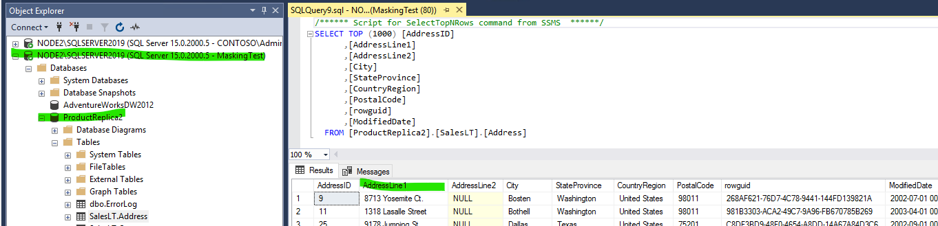

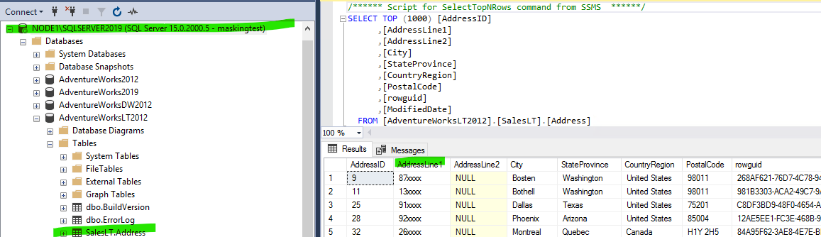

We are using Transaction replication in our database. We need to mask a table which exists in both publisher and subscriber database.
When we are applying dynamic data masking on that table in both publisher and subscriber database, it get applied on publisher but on subscriber we can still see the unmasked data.
Could someone help me to conclude if Dynamic data masking is feasible in this scenario. Thanks

  1. Guoxiong 8,206 Reputation points
    2021-06-11T14:37:32.333+00:00
    I tested it on my local SQL server with both publication and subscription databases on it and it worked. I guess your publisher and subscriber are on the different servers. Make sure you run REVOKE UNMASK TO 'UserName' on both servers.

  3. CarrinWu-MSFT 6,891 Reputation points
    2021-06-14T06:31:39.573+00:00
    Hi @Murlidhar Patil ,
    Welcome to Microsoft Q&A!
    I made test for your question, and also get same result that can see the unmasked data on subscriber. In addition, if the Subscriber republishes data, the only supported schema changes are adding and dropping a column. These changes should be made on the Publisher using sp_repladdcolumn (Transact-SQL) and sp_repldropcolumn (Transact-SQL) rather than ALTER TABLE DDL syntax. Please refer to Transactional Replication.
