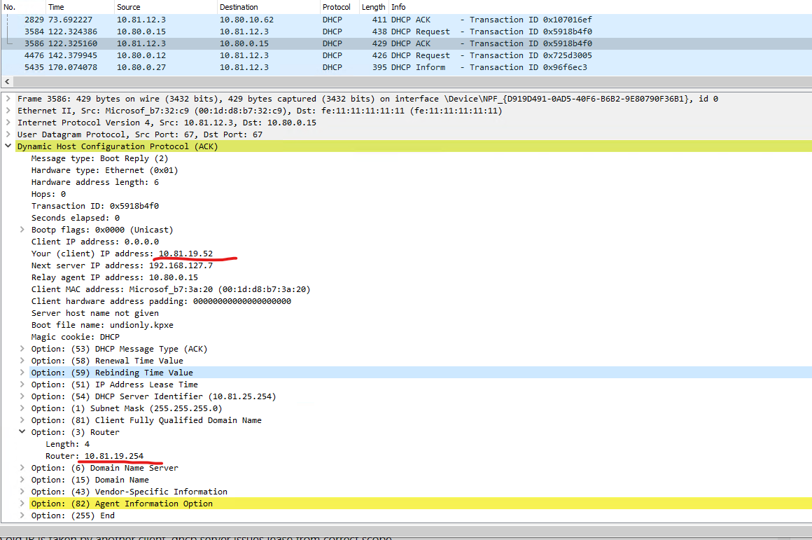

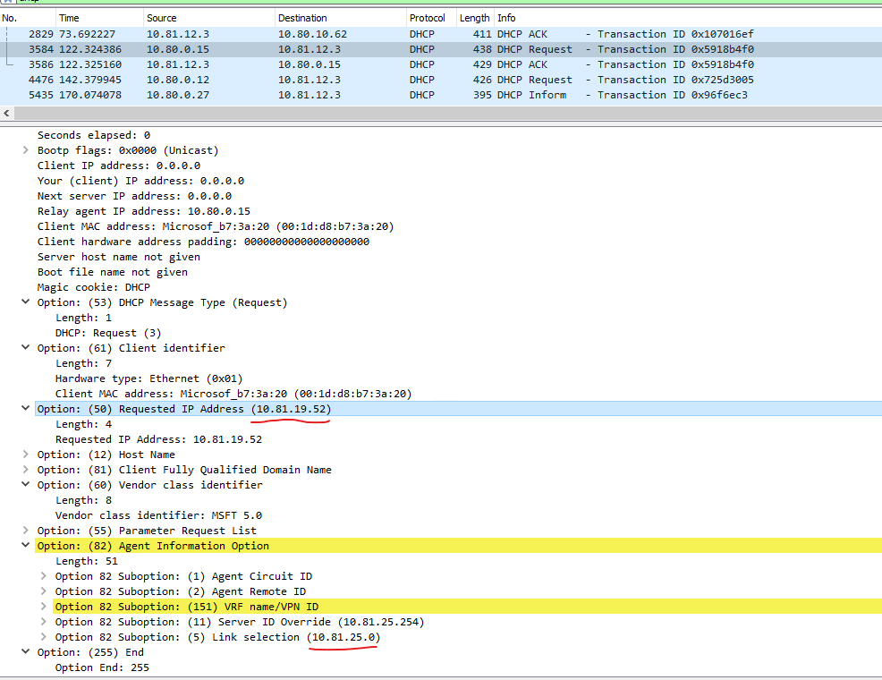

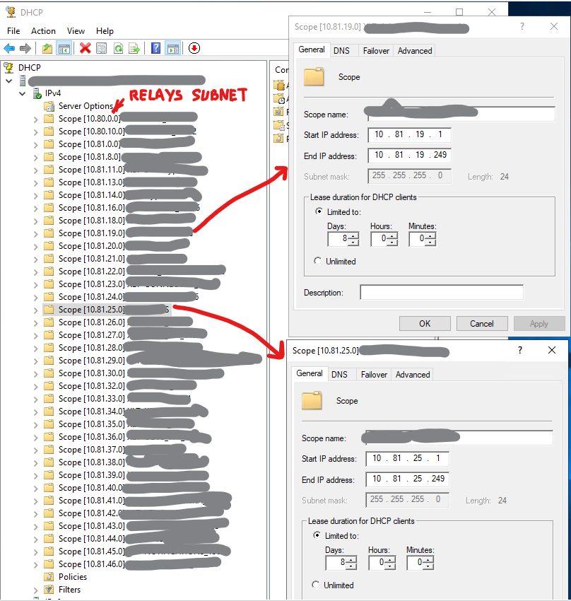

I'm attaching screenshots of dhcp request/reply and scopes config
client on subnet 10.81.25.0/24 specifies requested address 10.81.19.52
dhcp ACKs adress 10.81.19.52, ignoring subnet in link-selection suboption
scopes config
