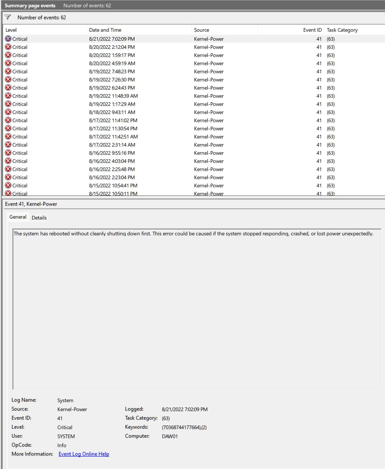

How do I tell what is causing these all the time? Computer doesn't BSOD, hang, restart, etc

    Most likely the unexpected shutdown causes the minidump creation to fail. Have you tried to reseat the Graphics card, Processor, and memory module/RAM?
    2022-08-22T08:43:30+00:00
    This folder is empty. It doesn’t crash just has hundreds of these critical events. Isn’t there a way to know what triggered it? Why is it so hard to find this out?

    2022-08-22T03:56:43+00:00
    Thanks. I have a 1200W brand new power supply in a brand new PC I built with a Gigabyte z690 Xtreme motherboard, 4 brand new Samsung Pro m.2 SSD drives, 64GB of RAM, 24 i9 cpu cores at 3.2 GHz. No overclocking and default BIOS. I know all the basic troubleshooting techniques, but I think there is a data dump or log file that will tell me what is throwing that error? That's really all I need to know. Thank you.

    Error: Event ID: 41
    Description: The system has rebooted without cleanly shutting down first.
    This error indicates that an error prevented Windows from shutting down correctly or the computer shuts down unexpectedly. Most likely caused by an interruption in the power supply, overheating, or a hardware problem. Ensure that all power cables are attached properly.
