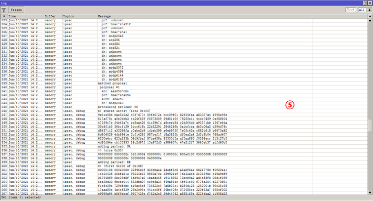

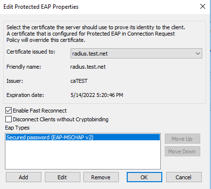

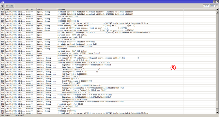

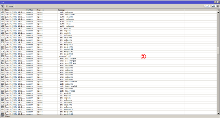

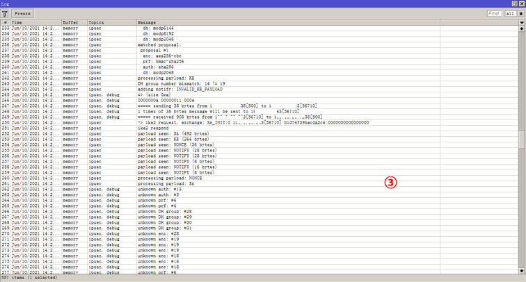

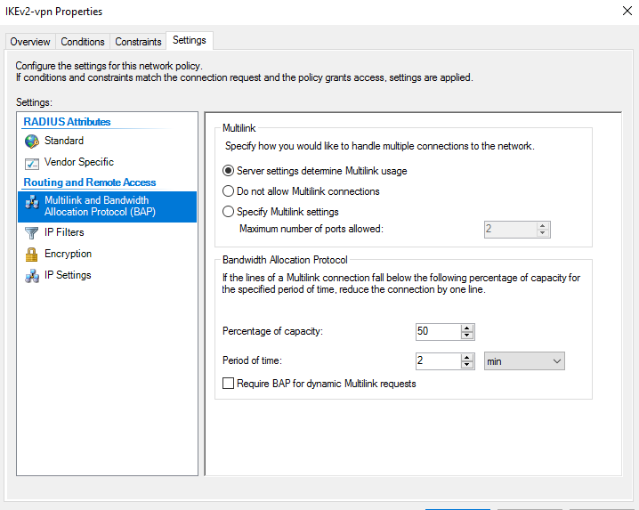

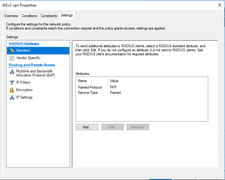

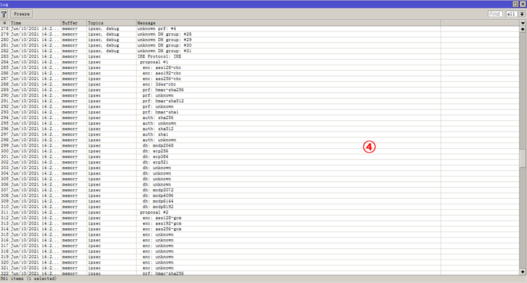

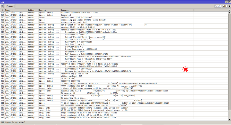

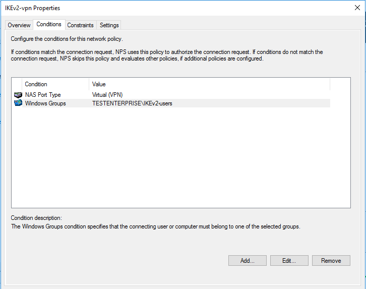

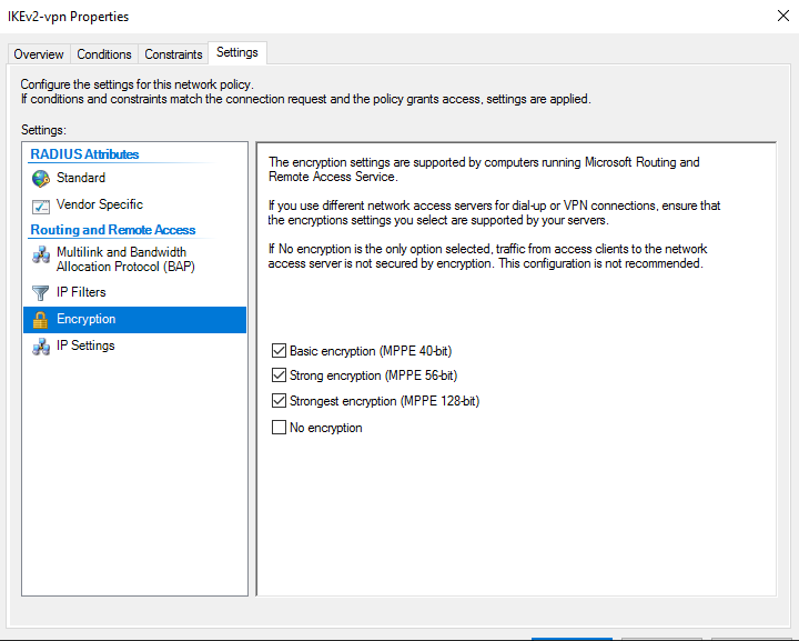

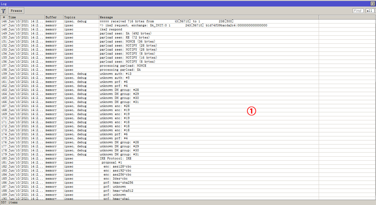

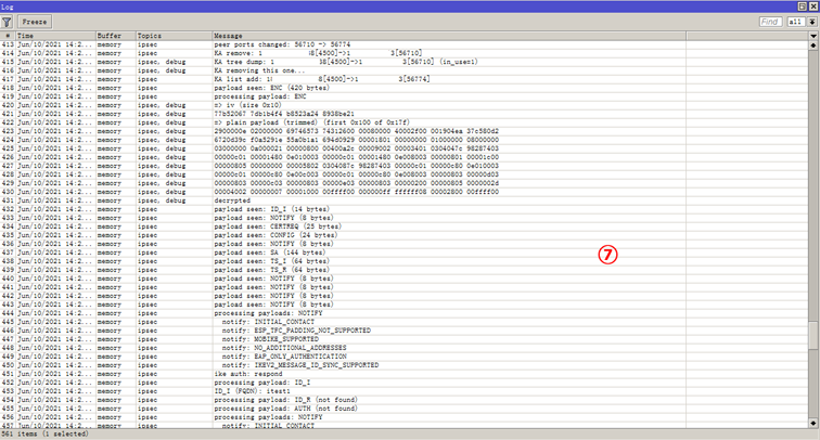

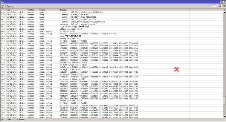

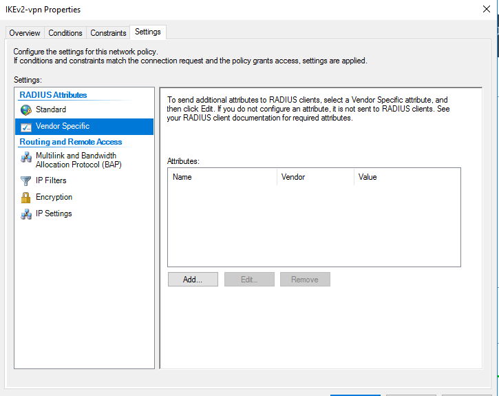

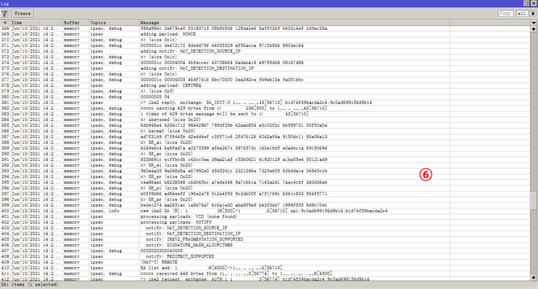

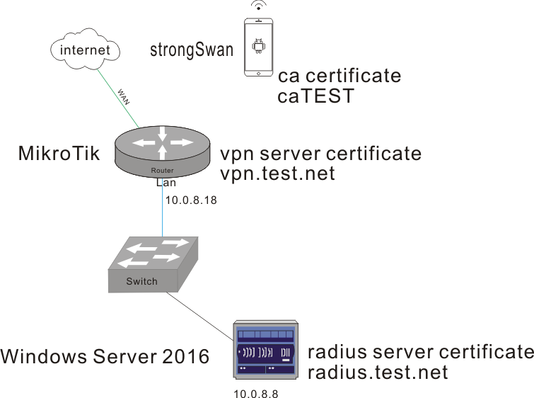

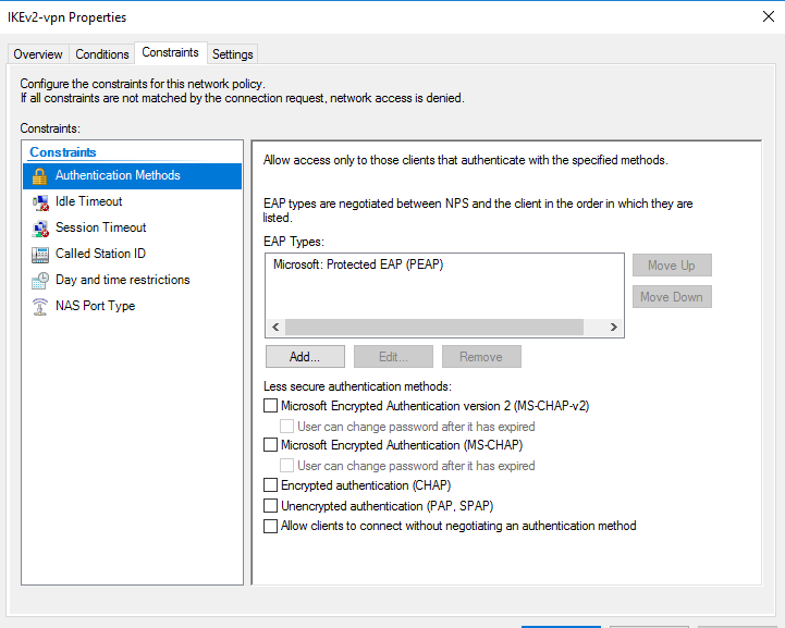

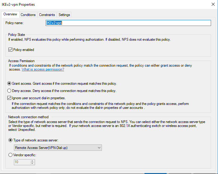

Hello,

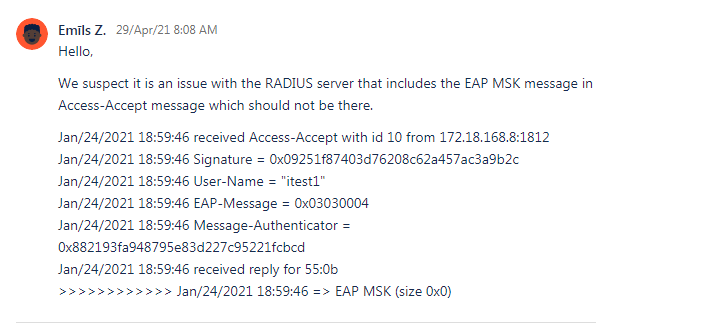

As shown in the attached network topology diagram: MikroTik router is used as VPN Server, and Windows server 2016 NPS is used as Radius server. The combination of the two fails to perform IKEv2 VPN authentication. The certificate verification is passed, but the account matching fails; I consulted MikroTik official Technical support, the answer is that it is a Radius server problem, see the attached picture, I searched this problem in the Q&A community and found some similar cases,windows-server-2016-radius-server-ias-auth-failure.html
I followed the instructions in the article to modify the Radius server's registry, but the test was also unsuccessful.lt2p-ipsec-ras-vpn-connections-fail
Please analyze the reason.
strongSwan log:

105012-ikev2-vpn.png105013-mikrotik-support.png104978-strongswan-log.txt104985-network-policies-1.png104965-network-policies-2.png104986-network-policies-3.png104966-network-policies-4.png104987-network-policies-5.png104967-network-policies-6.png104988-network-policies-7.png104968-network-policies-8.png105014-log-01.png104969-log-02.png104996-log-03.png104970-log-04.png105006-log-05.png105044-log-06.png105045-log-07.png104997-log-08.png105046-log-09.png104979-log-10.png
