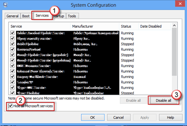

    You can perform a clean boot, then open the game to see if the problem exists.
    1. Log on to the computer as an administrator.
    2. In the search box on the taskbar, type msconfig, and then select System Configuration from the results.
    1. On the System Configuration Services tab, select Hide all Microsoft services, and then select Disable All.
    1. On the Startup tab of System Configuration, select Open Task Manager.
    1. Under Startup in Task Manager, select the item for each startup item, and then select Disable.
    2. Close Task Manager.
    3. On the Startup tab of System Configuration, select OK. When you restart your computer, it is in a clean boot environment.
