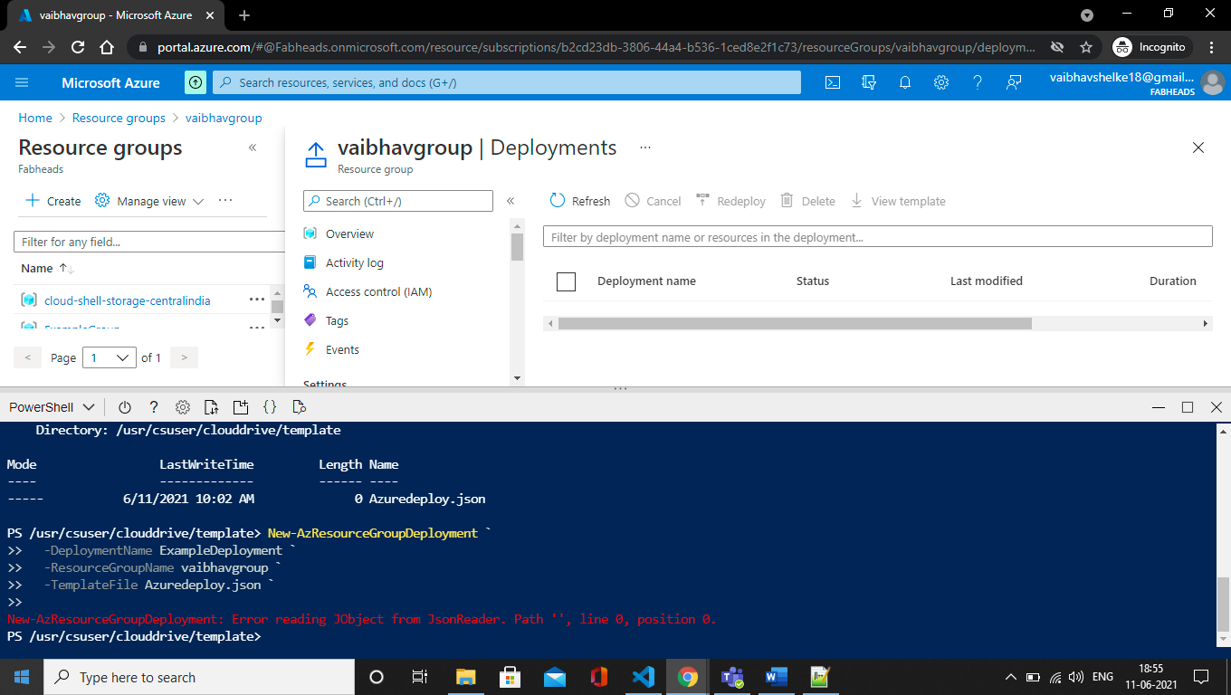

I am trying to deploy local ARM written in JSON to Resource Group using cloudshell with both CLI and Powershell but faced error while parsing. PFA snaps to see error and code105101-screenshot-5.png105102-screenshot-6.png

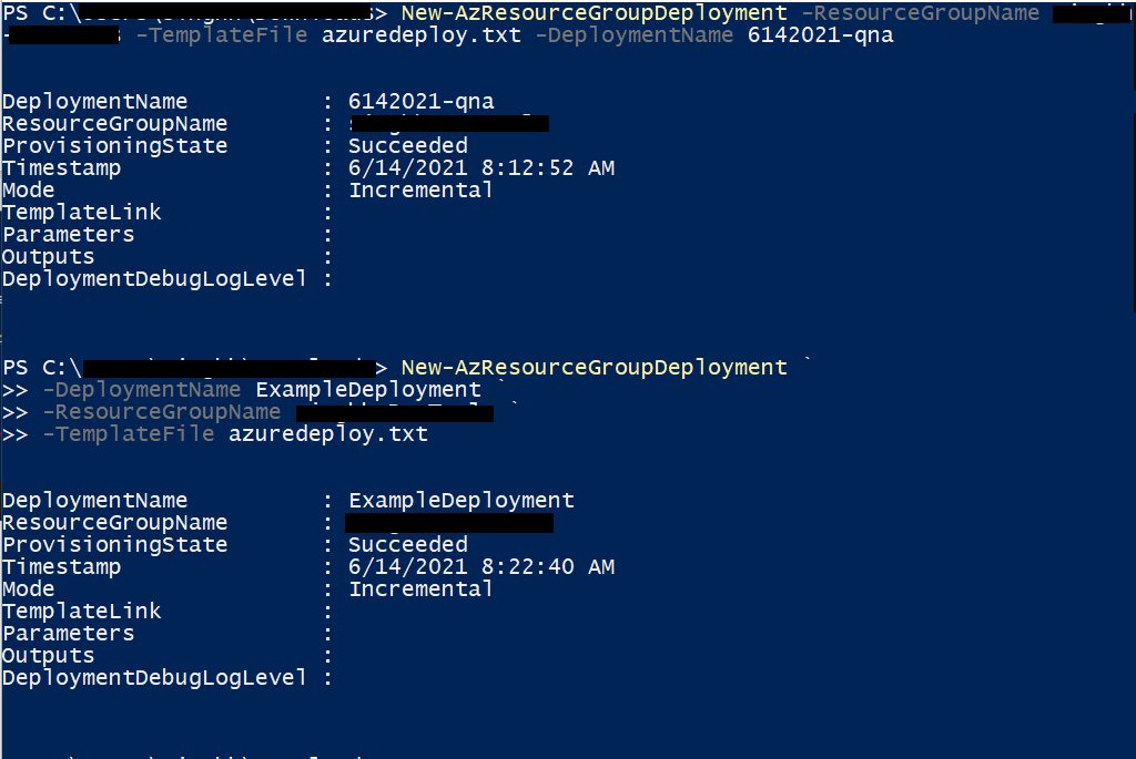

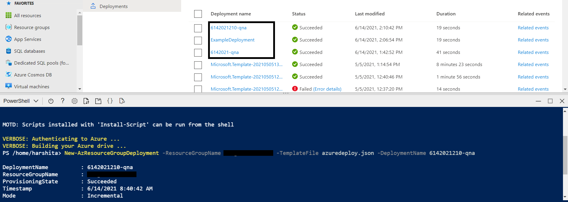

    @vaibhav18 , thank you for reaching out to us. I tried deploying the azuredeploy.txt as both .txt and .json files you had shared in the comments and was able to deploy it successfully:

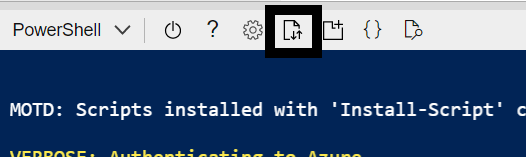

    I suspect that the JSON/TXT file is not correctly uploaded. I suggest you to rename and re-upload the file using upload option in the Cloud Shell and try again:
