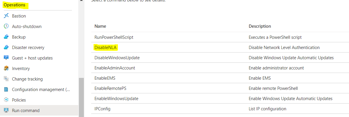

    In Azure portal - VM blade - go to operations - Run command - disable NLA
    after disable NLA try to login & check, refer below screenshot.
    refer- https://learn.microsoft.com/en-us/troubleshoot/azure/virtual-machines/cannot-connect-rdp-azure-vm
