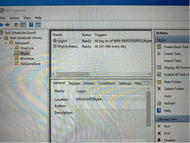

In our organization for ease of use, we would like to change the reboot frequency from Daily to a longer time period. When this adjustment is made using the Task Scheduler, the frequency is changed successfully. However, if at any point the system is rebooted (manually or by the period assigned), the Task length reverts back to Daily. How can this be adjusted?

    2022-04-28T12:20:56+00:00
    Hello,
    The MTR device is the same windows 10 OS with custom firmware/software on top. The Task Scheduler is the same, and comes pre-loaded with a setting "NightlyReboot" as you can see in the screenshot. This can be changed from Daily at 2:00 AM to any time that I would like. However, when the system reboots again at any point this setting changes back to Daily at 2:00AM
