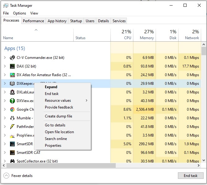

    When I right-click on a process I do not see "Set Priority"?
    My Windows version is 21H2, 19044.1706

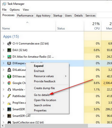

    Open Task Manager, on the Processes tab, find that process.
    Right click the process and select 'More Details'
    On the next Window right click the selected process and select 'Set Priority'
    From there you can set the priority of that process
